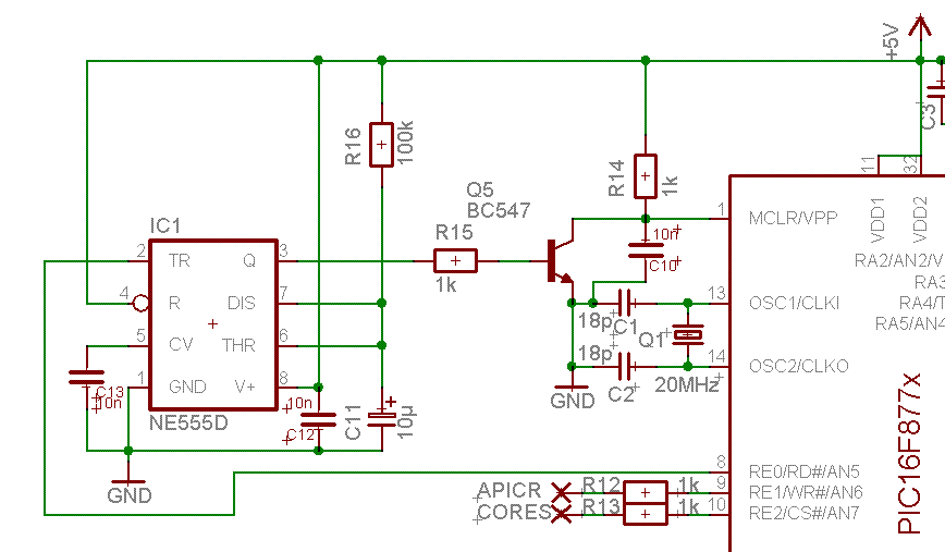

Hi, would this kind of reset circuitry work?
By taking RE0 low it would trigger the 555 and give a 1second pulse to Q5 wich in turn pulls MCLR to GND.

The circuit looks fine. But the question is what is the purpose of resetting the pic in intervals? If you are worried that the pic may hang after some time, there is always the watchdog timer.

I've not studied your exact circuit, so can't comment on that, but certainly the principle is fine.
You could use a similar technique as an external watchdog timer?, by wiring the 555 as a one-shot monostable, and using a transistor connected to an I/O pin (via a capacitor) to discharge the timing capacitor. The PIC has to output a pulse to the transistor BEFORE the 555 times out and resets it, if the PIC is locked up in some way it won't supply the pulse and the 555 will timeout reseting the PIC.
This technique is quite common in TV's and VCR's! - although not usually using a 555 or a PIC!.

why do you need the 555? You can use RE0 to pull MCLR down directly...
If you need a 1second delay or something just do that in software...

You can't do a 1 second delay in software, as soon as MCLR goes LOW the PIC stops running, then as it goes high again it starts running from a full hardware reset.
I know that...
What i mean is whatever you want to do with that external 1second delay reset, you can do it in software too...
program a timer delay to set a flag (or interrupts) after 1 second, once that flag is set pull MCLR low directly with RE0...
while the timer is running you can still do processing ...
perhaps more information about what this supposed to be doing in the context of the project could come in handy...
I presumed that the delay was to initiate a clean reset?, although a full 1 second isn't required - and personally I'd probably try just a simple capacitor from I/O pin to MCLR, rather than the complexity of a 555.
It doesnt really matter what he had in mind does it?
Eighter he wants a 1 second delay between the point in the program where the reset is triggered and the actual reset - wich can be handled in software like i explained above.
Or he wants to use the 555 to extend his reset pulse to be 1second long - This isnt required, just connecting an output pin right to MCLR is enough to pull it low and do a reset.
You can all do it directly...
