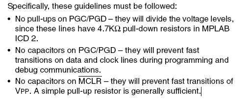

How come that all the circuits and icd2 manual have a pull up resister for MCLR, i know that its logic 0 activated, but i thought that the pins on IC's go high if there not connected,
so why is a pull up needed?
also you cant use pull ups on PGC/PGD, again doesn't the same apply here,
so does this mean that you basicly cant use R6 and R7 as logic 0 activated switches, because you couldn't have them usually pulled up when not pressed,
but you could have them as logic 1 activated switches, where they would usually be pulled down, when not pressed.
Why did you think that?, it's not true.
With CMOS inputs (like in a PIC) it's important to have the input pins connected to 'something', otherwise their high impedance 'may' allow the pin to drift high, increasing supply current many times, and possibly even triggering the input.
To pull the reset pin high.
You should pull them high or low, with resistors, to ensure the default state, then switch to the other state. PortB on most PIC's has internal pull-ups, which can be enabled by a bit in a register.
Well im just following the ICD2 manual, but when it says that you can't use pull ups on the pgc and pgd inputs, this is just for the programming right?
so if i was to have pull ups on on RB6 and RB7, i could put them on after the programming, is that right?
Yes, assuming that was what you wanted to do - but designing for ICSP always places constraints on the target design.
