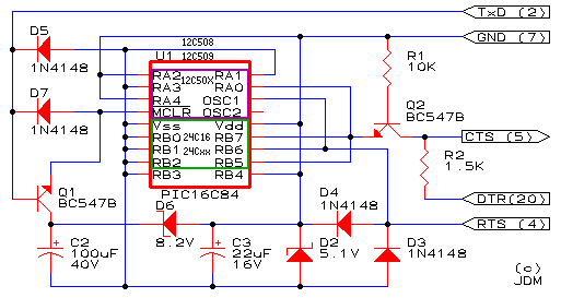

Hewwo. I was wondering if you could program PICs using just your com and a breadboard. I have those. Any info on this would be most appreciated.

There's loads of PIC programmer designs about, the simplest probably been the JDM 'serial port' versions - which are fine if your PC has an over spec serial port (many have).
Personally I would recommend a parallel port programmer, most of which are based on the enhanced version of the original David Tait design, in particular I recommend the P16PRO40.

You can get the scematics and programming software for P16Pro40 at nigels site www.winpicprog.co.uk
Other software and programmer designs are available at IC-Prog's site
JDM is amongst them, but like said above it relies heavily on your com-port specs and might not work if your com can't supply enough voltage.

Here is a schematic I found many years ago of the JDM programmer. You could probably assemble this on a breadboard fairly quickly. It should work fine with a 16F628 but will be dependent on you having a compatible com port.
