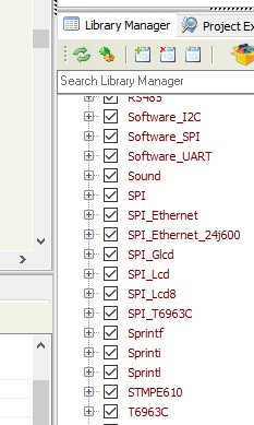

Merci Ian,
Will try and understand. But unfortunately I think sprintf doesn’t run on PIC 16F ... Will switch soon to 18 F ...
All three are available to you... You have to select them ( separately ) from the library manager.
They are normally not included.. When the compiler asks "include all libraries" you would have said no..
Merci.
I already used this way while trying to run a former code with sprintf with 16F877 and 887. Could only use sprintl or sprinti.
