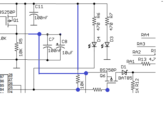

Pic kit 2 clone vdd short when troubleshooting

No chip has been connected, through any of my problems and lead lengths, don't even come into it either.The issue I have is the usb voltage, measured at the pins of the op amp and microcontroller, never make it to vdd output and that is due in part to the op amp rail limit.Others have had to change components to get results that work. External power for vdd ensures this problem is eliminated .The chip can be read if vdd is powered by the target and not by the pic kit clone.
There something wrong how Q6 is being powered the gate needs to be pulled up the the USB 5 volts with a 10 K and a 2.7 or 2.2 on the gate.
Finally there is light at the end of a very long tunnel !!! I can confirm that the clone can read, erase and identify a chip in this case a pic 18f 2550, but only when vdd is supplied by the target and not the clone. The external / target supply is simply three AA batteries in series supplying a healthy 4.7 volts. When vdd is supplied by the clone, it can only supply a maximum of 4.35 volts at the icsp pin 2.The pic kit 2 software displays the device not found error , immediately throwing up a vdd error check device or target message.
The op amp used in my circuit is an mcp 602 package . The voltage supplying it and the microcontroller from the usb is 4.75 volts .The output of q1 never gets any where near this value due to op amp rail limits. After this voltage has dropped even furthur across d1 a BAT 85 schottky the voltage is only 4.35 volts. I am sorry to disagree with previous post replies but to read a device successfully the vdd voltage is important and in my case components used , voltage drops and the like are causing problems for an otherwise simple proven circuit that others have built with no issues. Why should I be any different !!
be80be it would seem from what you have said previously, there is an error in the schematic I am using . Which schematic are you using or referring to ? Why would it be such a departure from mine I wonder ?

be80be just to clarify pull up resistor on gate of q6 to 5v. What is the 2.2 or 2.7 from the gate for and where is it connected ? I am assuming this is instead of the connection from the op amp or aswell as ?
If you make changes as in blue wiring you should have a working pickitclone the unmarked resistor is 2.7 k

As Q6 is a P channel mosfet we need to drive the gate low to turn it on. The pic port output is active high and active low so it should not need either a pull up or pull down resistor. I asked the OP about 5 days ago in post #11 to measure the voltages on gate source and drain of Q6. under the conditions when it was giving a reasonable Vdd output and when is was reporting a short. (I am ASSUMING that he was using the first test for Vdd in the troubleshooting section under the Tools menu.) He measured the voltages on a different mosfet. He has not yet carried out this test and reported the results so we still do not have information to diagnose the problem. Also I agree with Sarma that the BS250 is not the ideal component for Q6. It should work with when the voltage on it's source pin is 5 volts but if the voltage from the variable voltage supply (IC2 and Q1) is set to 3.3 volts or lower and the BS250 has the worst case threshold voltage of 3.5 volts then Q6 would not turn on. Sarma suggested some more suitable devices in post #12. The OP also seems to be ignoring this advice. Until the OP starts giving accurate information and answering questions I am giving up on trying to solve his problems.
