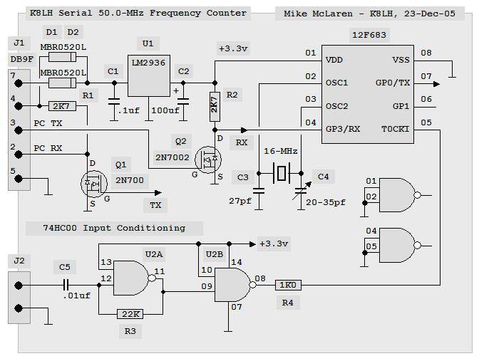

PIC is Timer1 good for a frequency counter?
Timer 1 is good for asynchronously counting a signal up to approximately 16-MHz where Timer 0 with prescaler is good for about 50-MHz.
Regards, Mike
And if you've been lookin' at the various example frequency counters out there, you might think you need to use a "gate" pin to freeze the counter input but that's not the case. It's easily accomplished simply with the single T0CKI or T1CKI pin.
Have fun. Regards, Mike

Assuming you're referring to the interconnected I/O pins?, it's NOT for gating, it's for manually clocking the pre-scaler so you can read it's value (as it can't be read by the PIC). This allows you to get a 16 bit value from the 8 bit timer!.

(1) The 1:256 prescaler can be read/flushed easily by toggling the TMR0 edge select bit in the OPTION register until detecting the TMR0 change (preselector overflow). The following code snippet (16F628A) is used to extract the 8-bit prescaler value once the counter has been stopped;
;  the counter input is gated off after 200-msecs, now finalize
;  our 32-bit count accumulator
;  ACCA+0, Most significant byte (TMR0 overflows)
;  ACCA+1, Next significant byte (TMR0 overflows)
;  ACCA+2, copy of TMR0 register
;  ACCA+3, prescaler, Least significant byte
        movf    TMR0,W          ; get TMR0 value                  |B0
        movwf   ACCA+2          ;                                 |B0
;  empty the 1:256 prescaler by toggling the TMR0 edge select
;  bit and decrementing ACCA+3 (initially 00) until detecting
;  the prescaler overflow into TMR0.
FLUSH   bsf     STATUS,RP0      ; select Bank 1                   |B1
        bcf     OPTION_REG,T0SE ; clock on rising edge            |B1
        bsf     OPTION_REG,T0SE ; clock on falling edge           |B1
        bcf     STATUS,RP0      ; select Bank 0                   |B0
        decf    ACCA+3,f        ; decrement counter LSB           |B0
        movf    TMR0,W          ; compare TMR0 to saved value     |B0
        xorwf   ACCA+2,W        ; prescaler overflow?             |B0
        bz      FLUSH           ; no, clock it again              |B0
(2) If you try to use the "gate" pin (the "interconnected pin") to clock the prescaler along with the 'live' signal you risk high frequency signals clocking faster than your prescaler increment "pulse".
(3) I have seen designs that used a 74LS00 or 74LS132 and another pin in addition to a "gate" pin that was used for clocking the prescaler, but why bother with the extra hardware and pins when software can provide the same capability?
Kind regards, Mike
