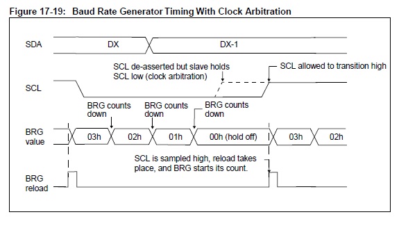

Dear All,
This is related to PIC 16f877a SSP I2C Master mode configuration
As per the attached picture, it shows BRG value start from 03h and it is time out 00h.
Can you please explain , what is the relation ship between ADDRES value and BRG start value.
Please advice
Thanks in advance

As per the PICmicro™ Mid-Range MCU Family Reference Manual
it shows
Baud Rate Generator
In I2C master mode, the reload value for the BRG is located in the lower 7 bits of the SSPADD
register (Figure 17-18). When the BRG is loaded with this value, the BRG counts down to 0 and
stops until another reload has taken place. In I2C master mode, the BRG is reloaded automatically.
If Clock Arbitration is taking place for instance, the BRG will be reloaded when the SCL pin
is sampled high (Figure 17-19).
Could you please guide me
Thanks in advance
BRG stands for Baud Rate Generator and is not to be confused with SPBRG. The BRG is an internal circuit that is used to divide down the master oscillator to clock the I2C module. If you check the table of "Registers Associated with SPI Operation" you will see that BRG isn't one of them.
Dear Mike, Thanks for the reply
1.What I got from your reply is, The value load to ADDRES register depend on the SCL frequency in the I2C master configuration
2. could you please explain, what should be the value start count down in the picture my first post
This is I found from the Manual
To initiate a START condition the user sets the start condition enable bit, SEN (SSPCON2<0>).
If the SDA and SCL pins are sampled high, the baud rate generator is re-loaded with the contents
of SSPADD<6:0>, and starts its count. If SCL and SDA are both sampled high when the baud
rate generator times out (TBRG), the SDA pin is driven low. The action of the SDA being driven
low while SCL is high is the START condition, and causes the S bit (SSPSTAT<3>) to be set. Following
this, the baud rate generator is reloaded with the contents of SSPADD<6:0> and resumes
its count. When the baud rate generator times out (TBRG) the SEN bit (SSPCON2<0>) will be
automatically cleared by hardware, the baud rate generator is suspended leaving the SDA line
held low, and the START condition is complete.
