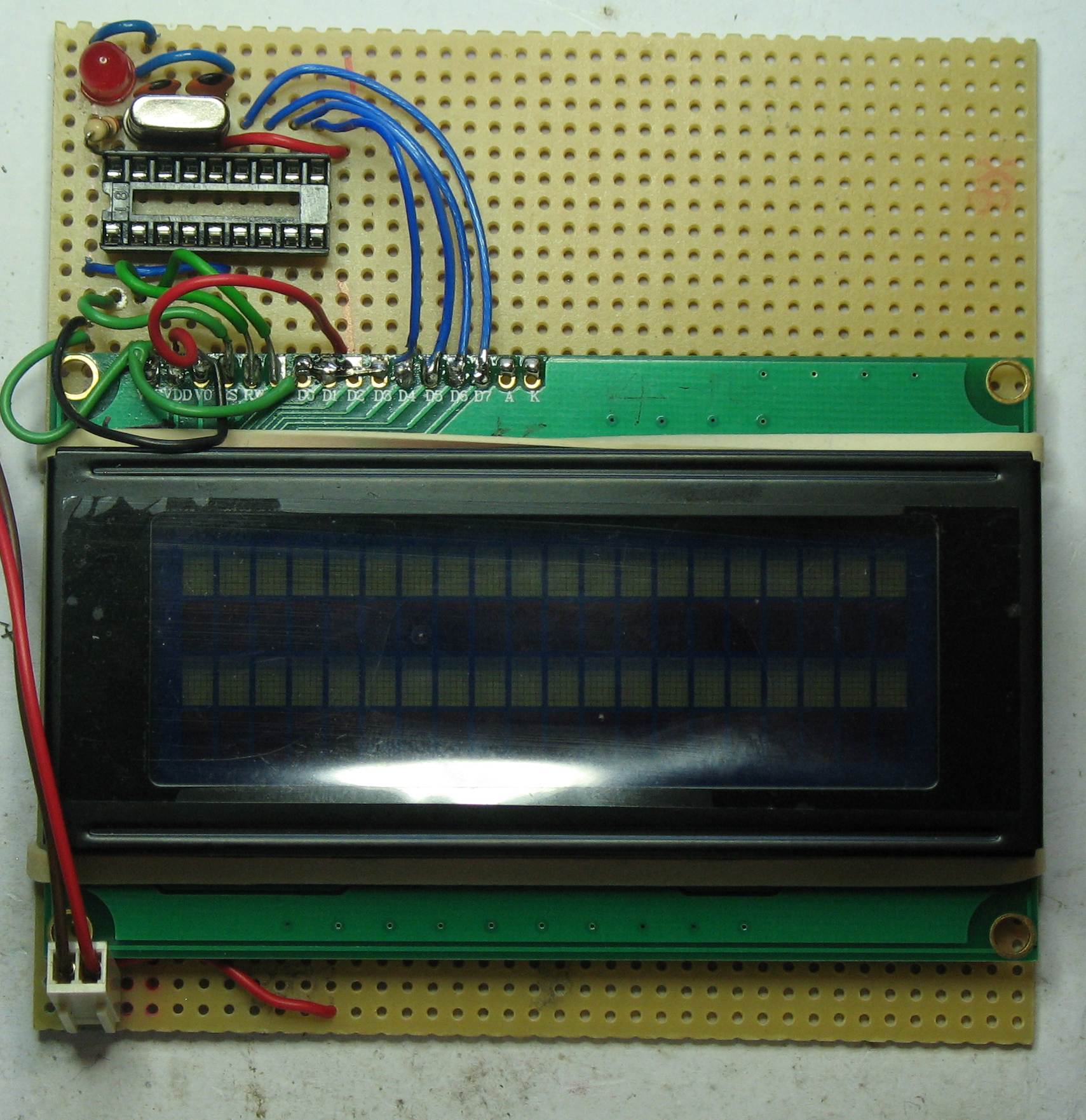

Hi, [16F648A with XTL and LCD 4X20 module.]
Can we start again from here, in case I've complicated things?
I have attached a photo, of the latest wiring, the Oshonsoft program and the code.
This program works ok in the Oshonsoft simulator, but not in the circuit. If I comment out the LCD part of the program except the 'TOGGLE RA1' which is an indicator LED, then the led flashes in the circuit.

The code is not correct with your schematic, 8bit lcd data vs. 4bit etc.
Long wires may give problems.

If that's actually the case, then that simulator is complete garbage. There is no way, exactly zero percent chance, that circuit that you've shown us, can make the LCD work in the simulated circuit AND the physical circuit with the same code.
And don't ground D0-D3 on the LCD. Doesn't need it. And if you are going to ground, I surely wouldn't put them directly to ground on the same wire. Bad practice. Always use a pull down resistor in line with signals that are being pulled up or pulled down.
But he is simulating different circuit with 8bit Lcd data. The physical circuit has 4bit Lcd data interface and might have other issues.

Is the photo I posted in #21 no good? I don't have a proper schematic, I'm only following ideas from Google like the one I posted. I've changed the wires round to clear pins 15 and 16 for a XTL.

Ok, now look very VERY VERY hard at your wiring...
Now look very VERY VERY closely at the first dozen or so lines of your code...

I did take the GND off, just didn't post a fresh photo, unless you want to see:)
Now I've looked a the code and my wiring, and call it dylexiar, but I can't see what you mean.

You don't listen.
There are at least four messages which tell you to look at your circuit and look at your program.
Are there some conflicts between your code and your circuit ?

Anyway! I changed these:
Define LCD_BITS = 4
Define LCD_DREG = PORTB
Define LCD_DBIT = 4
But it didn't work. (I tried it days ago) Is this somewhere near to what you are hinting?
