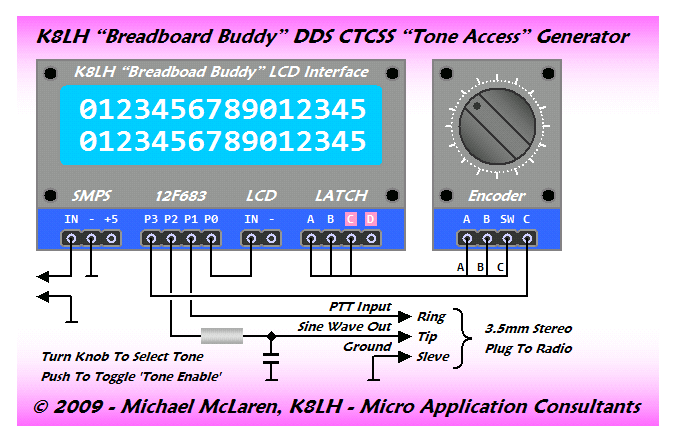

I'm just wondering if that Up/Down Rotary switch you have might actually be a Rotary Encoder? I haven't come across anything that puts out seperate Up/Down pulses as you turn it but I use relatively inexpensive mechanical Rotary Encoders with detents to provide that exact same function.
It's not a big deal to code an input routine for a Rotary Encoder or your OEM Up/Down switch but I just thought I'd mention it because if you have a hard to find OEM switch and it breaks then you might consider replacing it with a Rotary Encoder. The ones I use have 16 detents per revolution and a built-in push button switch on the shaft (drawing below).
Regards, Mike
Hi Mike, I have been looking for one of the switches today but the bag of them has eluded me, I am sure they are just direction selective momentary contacts. They were used for just the purpose I want to use them for. There was a variation used in the model previous but its operation was different in as much as they were not rotary you had to hold them in either direction against a spring and I believe it was not a popular means to change channels by hence the change. The controls were made by ALPS and they were interfaced to the micro that was in the radio and the radios had many more channels than the switch had positions, you just kept turning the knob. There are only 4 connections to the device 2 on each side and they meter out just as a closure and there is no continuity between either switch...
I will keep looking and see if I can track the ALPS number but they may be to old now. the switches I have are as good as brand new as we removed all control functions from the radios and replaced them with a dash top data terminal and GPS.
Thanks,
Don.....VK3YV....

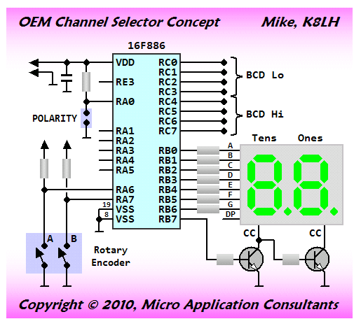

Ok Don. Like I said, writing code for your OEM up/down switch or a Rotary Encoder is not a big deal.
So it seems we're looking at a design that might look something like this (below) using a 28-pin 16F' or 18F' device with any number of simple design variations for the display, switch, etc.. Does this look correct to you and other Forum members (yes, I know the "ones" driver transistor needs a pull-down resistor on its base)?
I can't help thinking that this entire circuit could be replaced by a pair of BCD thumb-wheel switches which would display the channel number and drive the eeprom address lines. You would just need to connect +5v or ground to the "common" lines on the thumb-wheel switches to change the output polarity.

On the software side I was thinking there may be a couple advantages using a single packed BCD "channel" variable in the software. (A) you can write the packed BCD "channel" variable (inverted or non-inverted) directly to the eprom output port, and (B) the displays are easier to refresh without the need for a binary-to-decimal routine. The down side is that incrementing or decrementing a packed BCD variable uses a few more instructions.
;  ISR "display driver" code (8-msec intervals = 62.5 Hz refresh rate)
refresh

Hi Mike, the circuit you sent is exactly what I want even down to the pic box, its empty just as my knowledge of what is in there and how it works! Regarding the comment that it would be easier to put in 2 BCD thumbwheel switches, well that is what I am taking out as they are faulty mechanically and I cannot get any that are small enough to fit, and on checking with Farnell the prices are way out, I can buy 5 PIC16F886's for the price of just 1 BCD switch, no end plates or screws and into the bargain they are all to big. I don't have much room behind the panel, I have already trimmed the contact connections and the circuit board behind them and put some mylar in to stop them shorting, so out with the old and in with the new both physicaly and hopefully in my head (learning about PIC's) so be gentle I turn 67 in a couple of weeks and the only thing I have ever done as far as programming goes was way back in the late 60's when I played around with a 6800 and a 6809 but couldn't get my head around, it I am a practical hardware person in many fields, now by need I have to try and change. Some answers and questions. I presume whatever I do will have to be in Assembler, suggestion? please. My PIC Programmer does not list the 16F88X series but lists the 16F87X but the program that runs it WINPIC does list the 88x series and checking pinouts they look to be the same but the method of programming it has me confused but I think it will work. I am ready to order 5 16F886-I/SP's if it will work (28 pin dips). What does the -I and the -S mean I can't find any reference to it. What do I have to aquire to produce a hex file for the programmer? and what is packed BCD.
Enough for now just need to know if what I suggested will work so that I can order them and hopefully you can set me straight with my other questions.
Regards, Don....
You can use assembler, C, C++, BASIC etc. - you just need to get a compiler. There are a number of freebies and free trials. Microchip, hitech, boost-c/c++/basic (sourceboost: Index of /Products), crownhill and others supply limited compilers for free. They will be sufficient for your purpose.
-I is industrial temperature range. /SP is the package type (SPDIP)
