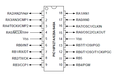

I had a look at the program and nearly understand. I have changed the ports so it would compile on Oshonsoft. These need to be changed to fit the 16F648A PIC.
Will it go onto this PIC? If so how many pins will I have left over?
Most of the changes are marked >>>>>>>>>>>>>>
2X attachments.
Cheers, Camerart.

Can you check the pin outs of the PIC 16F648 to make sure it is configured correctly please? I simply changed your program to ports that the PIC has without any thought, as I don't know how to set-up an LCD.
the oschon soft software automatically detects all of those things and adjust automatically.. so no need for that.. did you notice a dialog box showing "do you want to get lcd module parameter*" if yes then click yes. it will load the lcd module with the pin assigned by us.
I went through the ports and assigned the pins better?, and did press 'yes'. It could be working now. It didn't type "MORSE DECODER", after initialisation, but went straight into the loop. I have been trying to enter an 'A' into the input to make it type A, but so far no luck.
Camerart... Two things!!
1) The pic you are using has comparators on PORTA... Start the code with the " ALLDIGITAL" command, this will sort this out.
2) When simulating within oshonsoft you can increase simulation speed by using the " DEFINE SIMULATION_WAITMS_VALUE = 1"
This will change ALL delays to there fastest level. When you run it for real change to " DEFINE SIMULATION_WAITMS_VALUE = 0".
Also there is suppose to be a delay after LCDinit but as you are on the sim it won't matter.
Ahaa!
I've now changed to 16F819, does all of your message still apply?

Even more so... That pic defaults to analog pins on boot.... The ALLDIGITAL command makes them digital pins..
Also!! Remember to tris port a and b as they default to inputs...
Good luck
Hurrah! It showed "MORSE DECODER" first then 'A'
Thanks very much for your help Ian.
