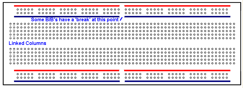

much oddness going on, i have rebuilt the board five or six times exactly the same way each time and no luck! then the seventh time bingo it works, so i assume the bread board is on the way out :( or its just one of those things, thanks alot eric at least now we have a better idea how to use transistors and trouble shoot them. i am starting to dislike bread boards as this is a long way from being the first time i have had trouble that ends up being down to a iffy board!
Note that on some project plug in boards the power tracks are not linked all the way along the board.
A decent quality project board will last for years if used correctly, I am using boards I bought 25 years ago with no problems.

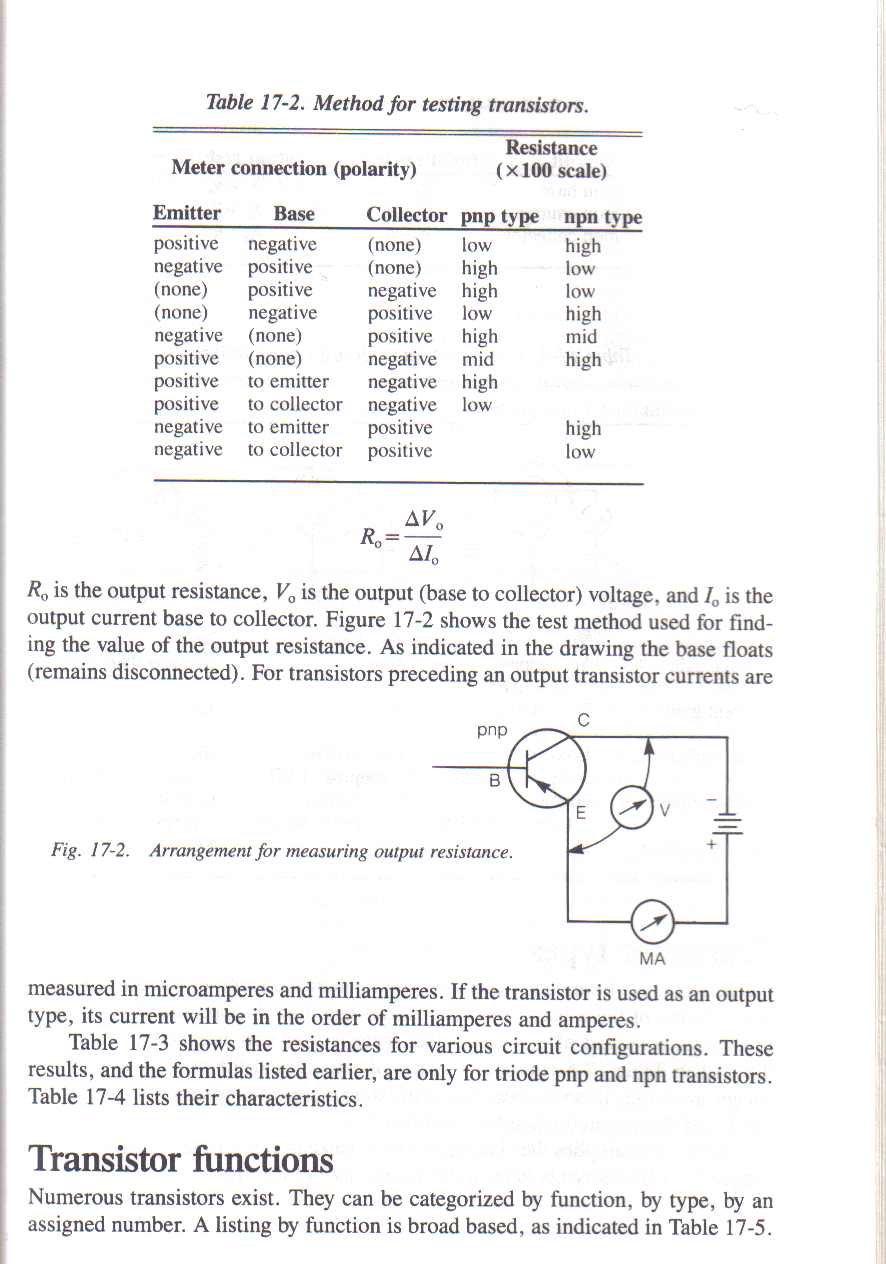

thanks for the pics eric. we have the switch working great now, all i can put it down to is there is one row on the bread board i have found that just dosnt seem to work correctly! it was indeed a cheap one from maplins i got a year ago, i got 2 at the same time and one has been ok and one has always seemed to give odd results now and then.
i did make one other mistake to wich i shall confess...........the first time i couldnt get it to work after spending 3 hours fault finding i had neglected to check the obvious...my bc547 npn transistor was infact the lm temp sensor:eek: :eek: ermmmm lets not dwell on that one tho lol.
