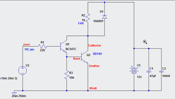

hello i have made a power supply from a pc power supply and i put it in a box. it works fine but it gets hotish in the box so i did a circuit with a pic18f1320 and a small pc fan to add extra cooling to the box my problem is turning on the fan from the pic pin i know i need a transistor and i have a npn one (BD139) but i cant work out what size resistor i need for the base of the transistor to get it to act like a switch (i have read up on it but cant do the maths) the fan uses approx 750ma the fan voltage is 12v the base voltage is 5v can anyone help me work out what resistor i need please
Well at a 750mA load and a min Hfe at 100...u need about 7.5 mA base current. Make it 10mA to be safe.
At 5VDC base voltage? PIC driven with pull up or direct from PIC?
If direct from PIC go with about 4.2V base voltage. V=Ir, therefore R=V/I = 4.2/.010 = 420 Ohms. Anything around that should be ok.

The medium power transistor will not have a gain of 100 when used as a saturated switch, more in the region of 10 to 20.
This would require a base current in the order of 50mA.
I would use your suggestion of connecting the fan directly to the 12V supply line.:)

If you have a BD139 and a BC547 you could use the lower power power BC547 connected to the two as a Darlington pair. Do you need a diagram.?

Diagram

thanks eric i will tell dad hi from you i have seen darlington on the web so beforeask you for a diagram i will try and work it out one question tho what size resistor do i use from pic pin to the bc547 base?? i am realy tryin to grasp the maths but its hard and i hate maths

See my last post EDIT
NOTE: you may need a small heat sink on the BD139 if it starts to overheat.

hi all, logan has run up against a small problem and its got me stumped, he has set up the circuit as per erics drawing but we couldnt get to make the fan run. so we stripped it all back on the bread board untill all we had was the bc547 transitor, no fan etc. what we get is only 5v at the emitter not the exspected 12V.
i have checked and double checked in the datasheet and i am sure we have the transitor the correct way round. so does anyone have any idea why we would see 12v at the collector but only 3.98v at the emitter when the transistor is "switched" on?? i have tried several of theese transistors from the same batch and all are the same. when the other transistor is also added it also shows low voltage at the emmiter.
many thx chaps

Measuring from 0V to emitter should be 0V...
Do you have the transistor the correct way around,??
EDIT: image

hi eric according to the datasheet its the right way round i have also reversed it. at present i only have q1 on the bread board, what should the voltage there be?
You cannot just have the BC547 on its own, with the 10K emitter resistor and say a 1K collector resistor.
If you want to test the BC547 , connect the emitter directly to 0V and the base to via a 220R to either +5V or 0V.
Have a1k resistor in the collector to either +5v or +12v.
As you connect the base resistor 220R to the 0V the collector should go High [12 or 5v] when you connect the 220R to +5V, the collector will go low.

nice to be back. the npn checks out ok as per method above, so will rebuild board and try again!! might take a while one handed :D
much oddness going on, i have rebuilt the board five or six times exactly the same way each time and no luck! then the seventh time bingo it works, so i assume the bread board is on the way out :( or its just one of those things, thanks alot eric at least now we have a better idea how to use transistors and trouble shoot them. i am starting to dislike bread boards as this is a long way from being the first time i have had trouble that ends up being down to a iffy board!
