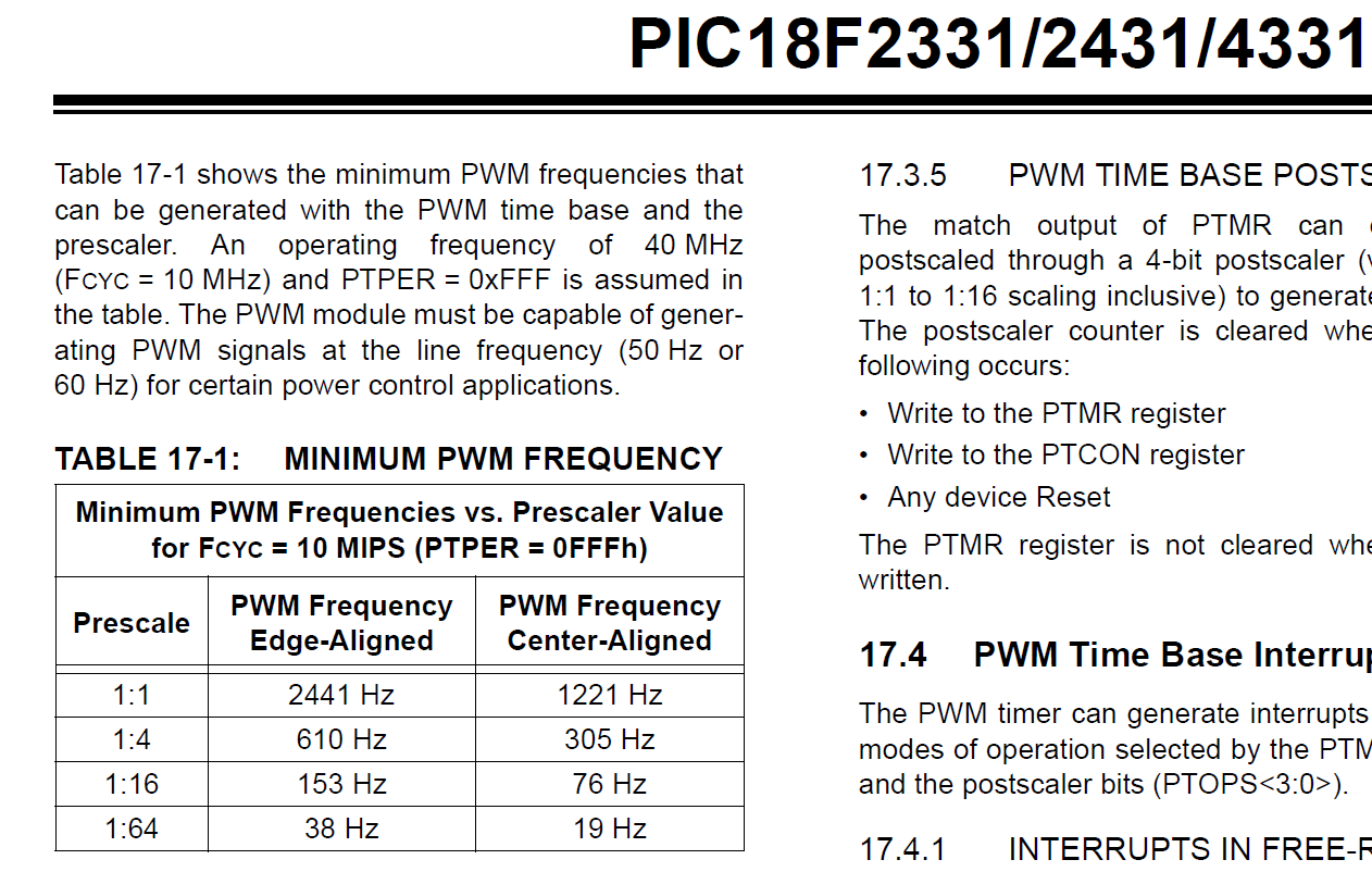

As per! I was wrong, thinking PWM.... Servos use PCM … It make sense to me now... I remember a couple of years back working on JPanhault's aero endeavours… We had all sorts of servo driving software... Believe it or not, this was the one we went with..
PWM was in my head because recently we've been messing with Arduino PWM outputs....
Thanks Mike... Oh and Mike....
With PICs, to use PWM for servos, the "secret" so to speak, is to have an additional prescaler allowing to output a frequency, low enough, as required by them.
That is common (not sure if with all PICs) with ECCP modules. In some of the manuals (if not all) the example on how to reach 50 Hz is detailed with numerical values.
IIRC, 18F4431 is one.

As I said in a very early post, you cannot get the prescalers to slow to 50Hz pwm. You also need to slow the CPU clock speed from 4MHz to 500kHz. That allows hardware to control the update.

Here you have it. As I said, at 40 MHz; nothing less.
Sorry it is the Power Control Module.
Any chance you or Gophert can provide an example? Does the method provide a usable pulse width resolution?
TIA... Mike
TIA... Mike

Thank you for the explanation. Unfortunately, I don't think I can do much with only sixteen 64-usec steps across that 1000-us range.
