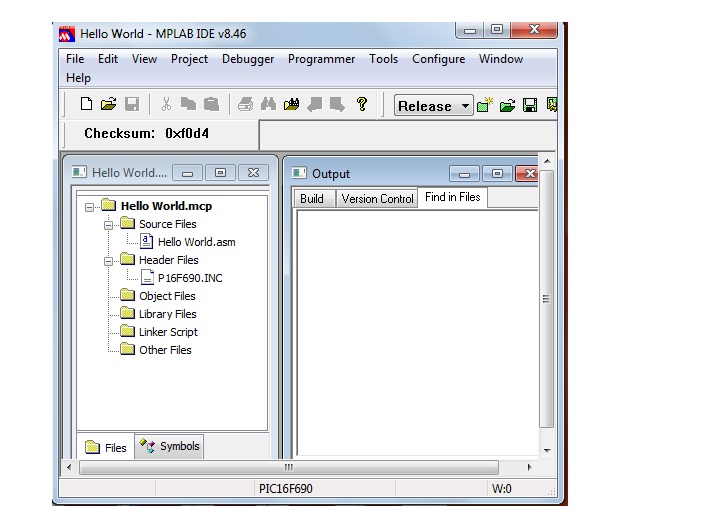

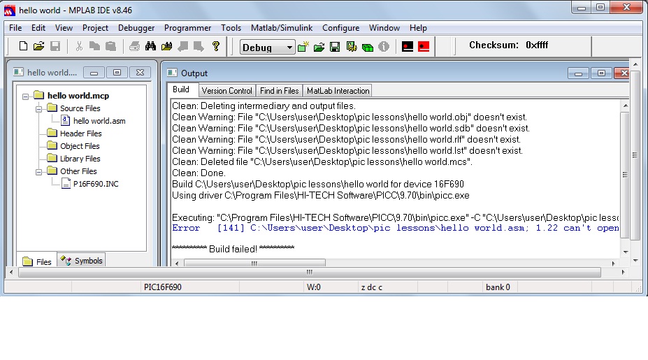

how do i get it to look like pic not pic1
Which programming language are you using to write the programs.?
Is it HITECH C or assemmbler.?
You don't use HiTech c for assembly, you use that for writing code in c.
If you want to program in assembly follow these steps:
1) In MPLabClick on Project -> "Select Language Toolsuite"
2) in the new window, choose "Microchip MPASM Toolsuite" from "Active Toolsuite"
3) Click "ok" and try to build again
