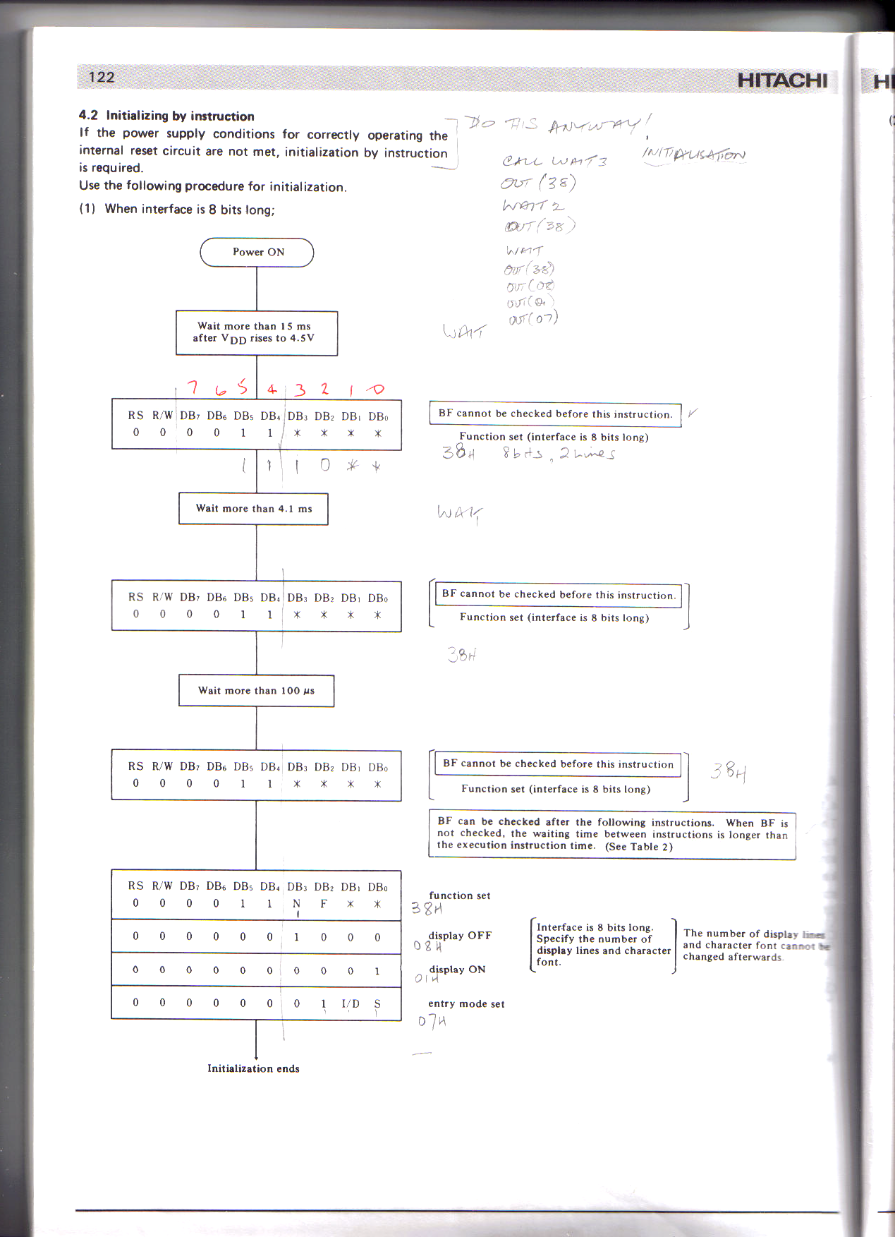

The attached data sheet from RS components has it on page 7. I always use this sequence and so am not aware of any LCDs that fail if it's not used.
This is a scan from the Hitachi manual, excuse the low quality.

Here's the relevant part.

hi Mike,
Thanks, the link name you posted has a Chinese looking character as part of the name.??
That data you posted is the same as the original Hitachi doc which I got about 20 years ago.
As I was manufacturing commercial products using these LCD's I had to be sure if the user replaced a faulty LCD, the new one would work, so I always used a software init.

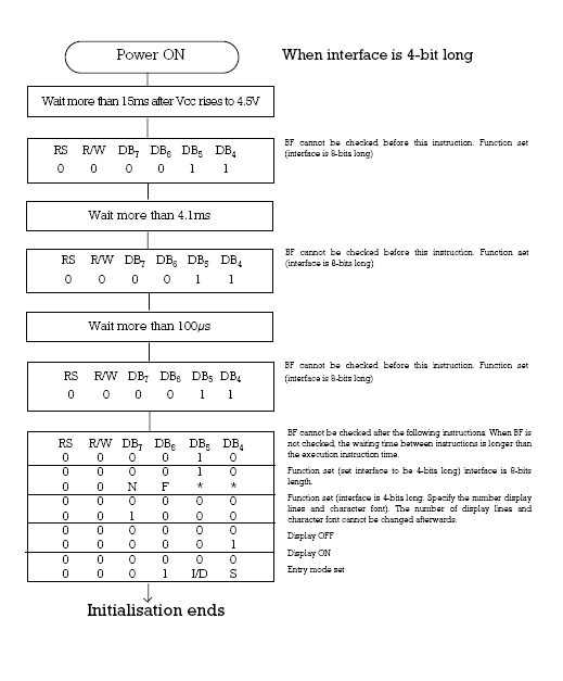

But I have one question,
reading the data sheet that shows how the initilization is done how does it differ from the code in nigels example? Isnt that what he is doing in the LCD_Init routine

hi Charlie,
I would add the initialising routine as per the datasheet.
If you post your working/latest code listing, we can show you how.
Eric
Here is the code that I have been using.
As you can see the LCD is being initialised.
If you could show me how it is different from the datasheet and how to correct it I would most appreciated.
Your data sheet shows 8 bit mode, i am trying to controll this in 4 bit mode.
Charlie

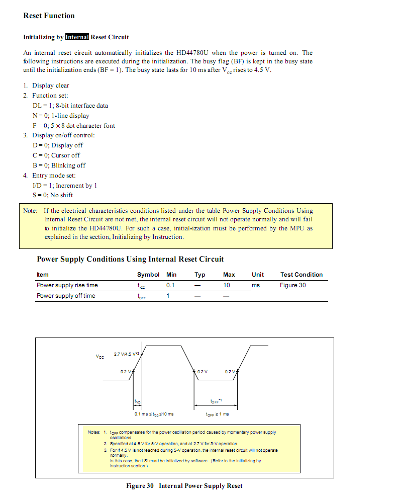

hi Nigel,
I have found that if the power supply does not meet the rise times expected for the LCD it will not internally reset.
So in many cases where the OP gets this 'failure to auto reset' it could be related to the way he is powering the PIC/LCD.
If the users power supply has 'large value ' capacitors on the output of a regulator this can also cause slower +5v rise times which cause a reset fail.
My advice to users who get LCD initialising problems, would be to state in their posts how the PIC/LCD is being powered.
Attached are some clips from the Hitachi manual.
