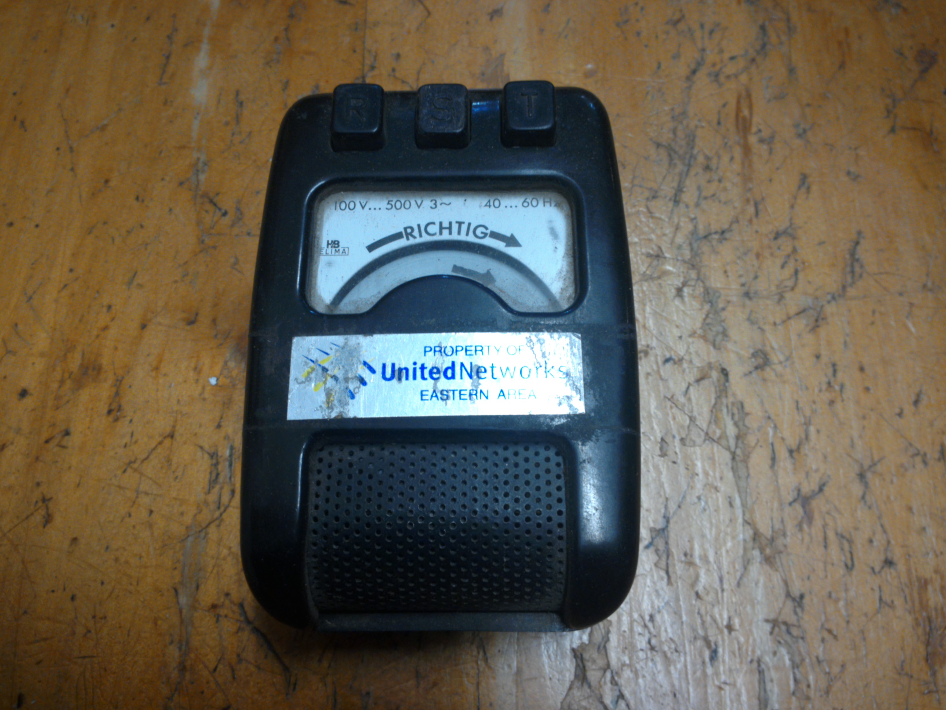

I use a simple electro-mechanical Phase Sequence indicator. (rotation meter)
It is basically a small three phase motor with alligator clips and potential lights.
No reliance upon batteries, as it draws the power from the mains.

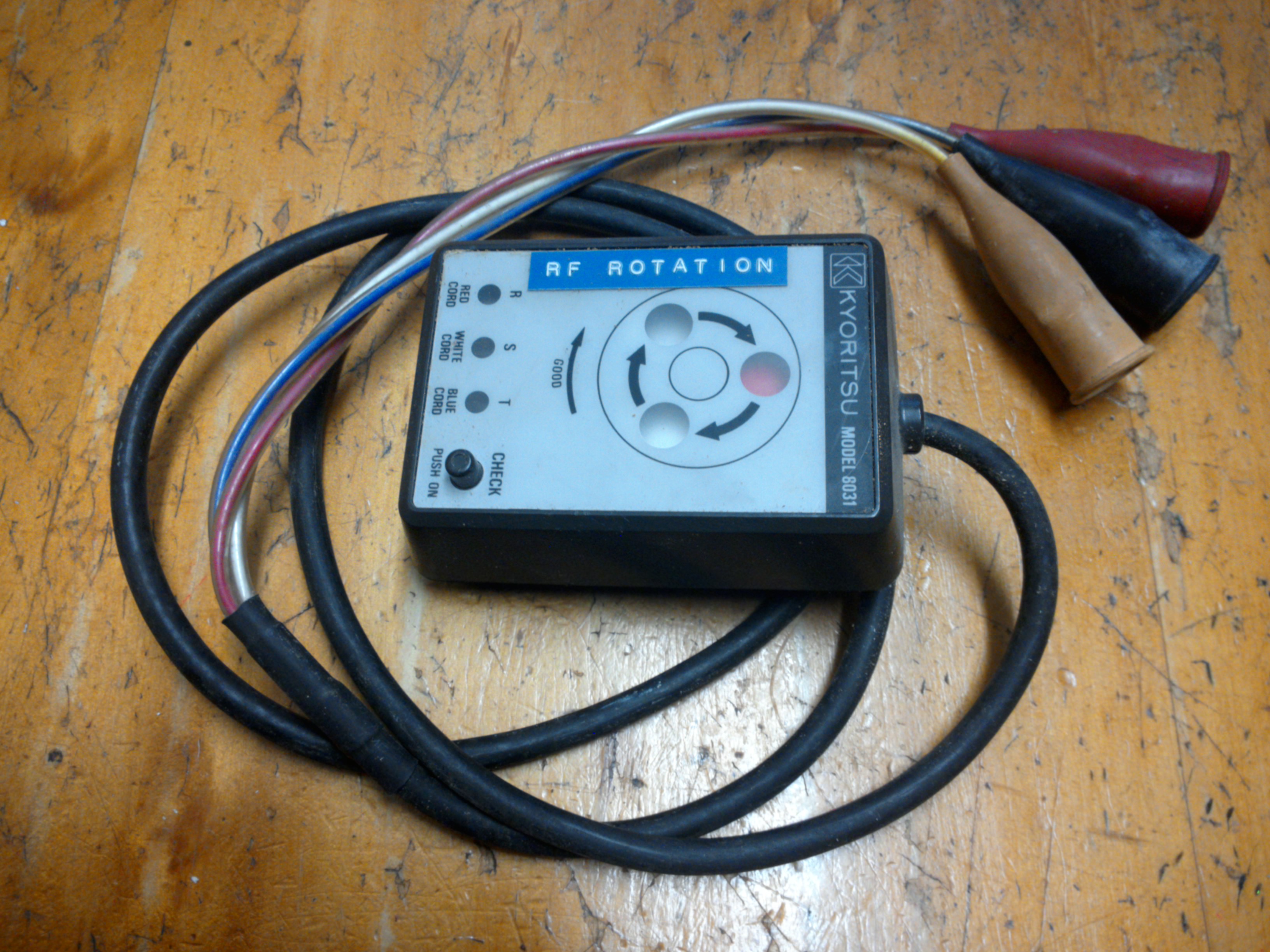

This Kyoritsu 8031 is a very reliable meter.
I use a newer version now with fused leads.
The other is an older German meter I sometimes use as well.
