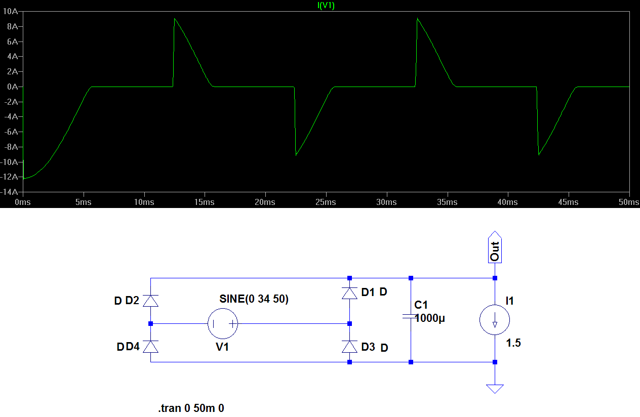

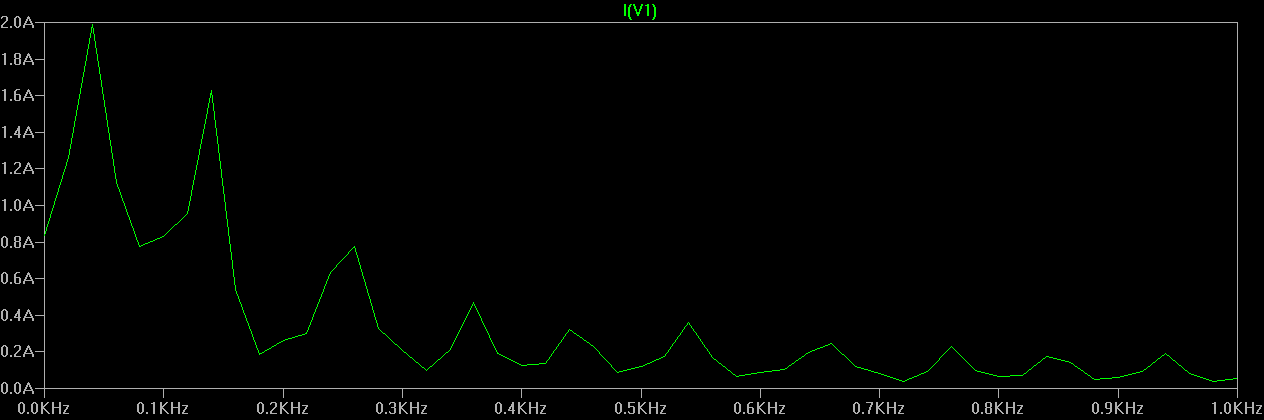

A modern TV has a switching power supply so you cant actually consider it a reactive load like a true transformer. Its more complex than that and can often create false readings on digital power factor meters.
The old school analog units will show the real PF while the digital will show what some programmer thought would be a good number based on a theoretical formula calculation referenced to the volts and amps readings derived from a complex time referencing system and what not.
I have seen digital PF meters get their high priced butts kicked by 50 year old analog units! I dont trust the digital units after seeing that first hand one time.
Just something to consider!
Yes, I do remember the harmonic distortion issue that we talked about.
If that is indeed the case, I assume that connecting a capacitor in parallel would only increase the bulk capacitor and wouldnt correct the power factor?
That's right a capacitor probably won't help.
A harmonic filter is the answer to non-linear loads.
