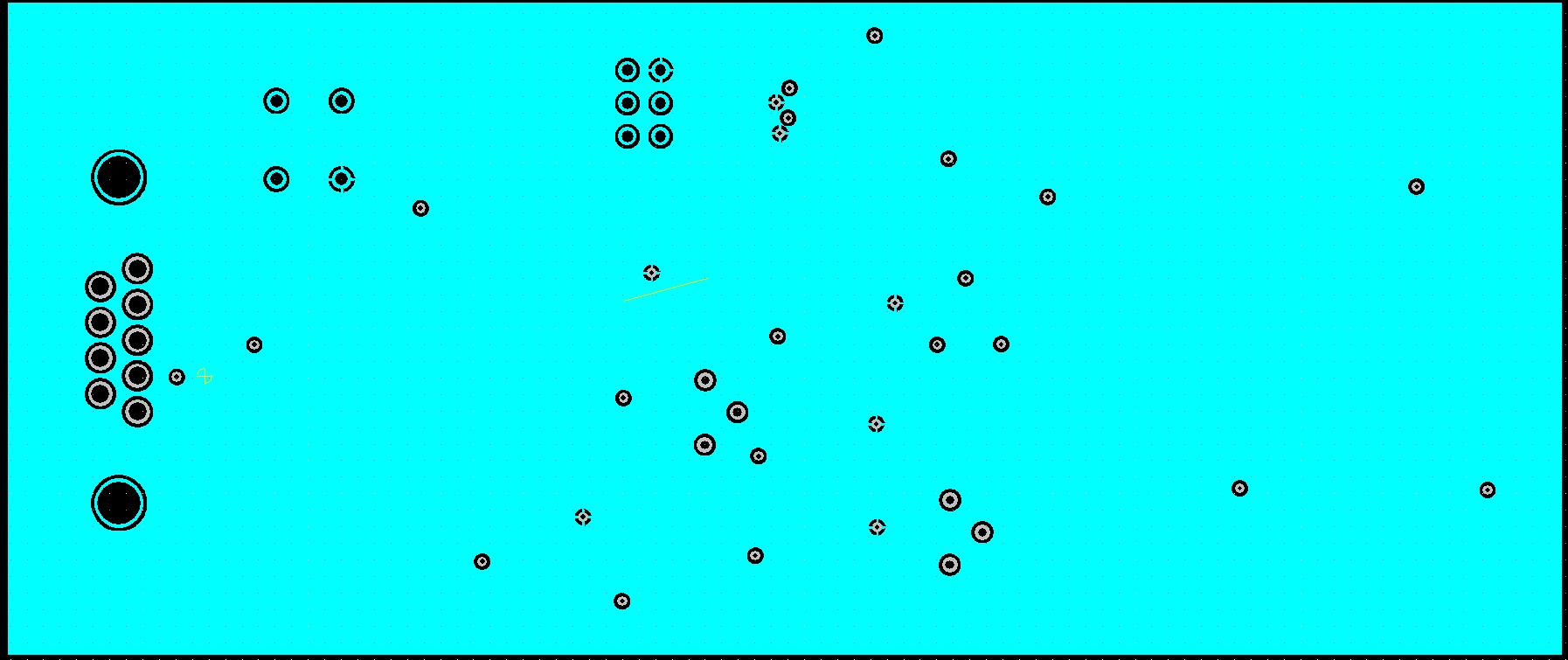

I am working on a Constant current load (adjustable from 250mA-2A) for a project. The load will be batteries around .6V-1.5V I bread boarded the circuit and it worked great. I transferred it over to PCB and not so great. It was a disaster. This is my first mixed signal pcb. Needless to say I didn't pay attention to where signals were routed and I overlapped digital and analog signals. I've since redid the layout. I'm hoping this will keep my analog and digital signals clean not talking to one another. If you all could provide any feedback and pcb layout conflicts that would be greatly appreciated. How could I improve this layout? Would ground plane cuts help with this design? I have attached the pcb file and schematic.

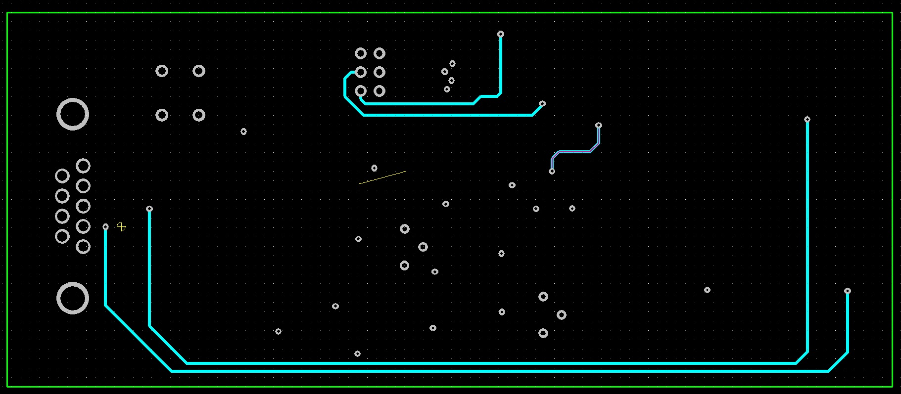

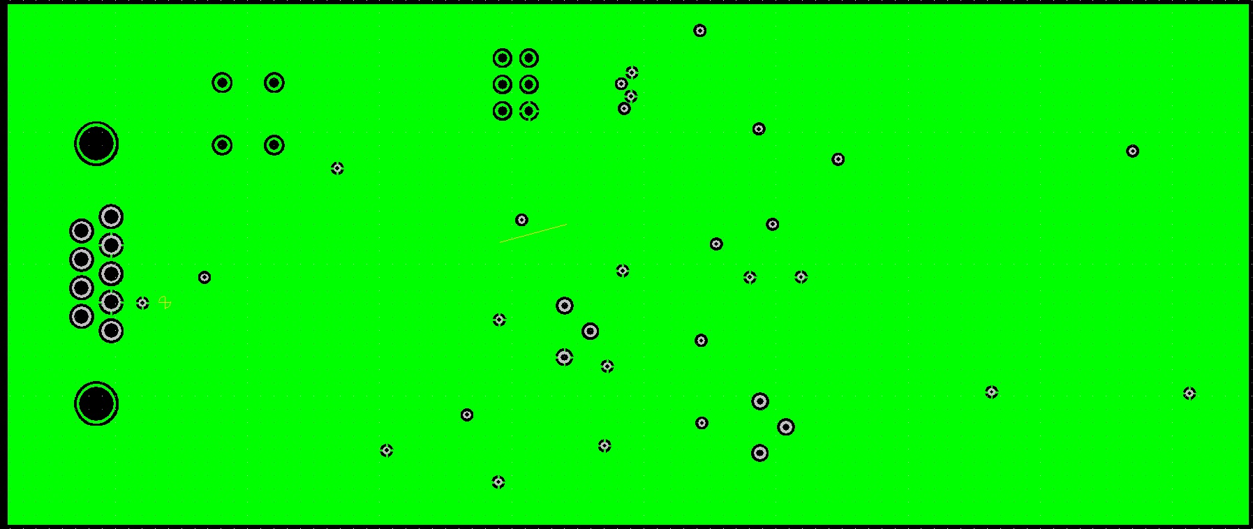

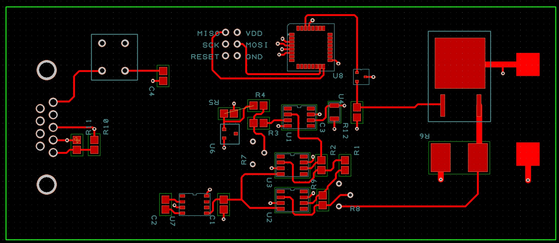

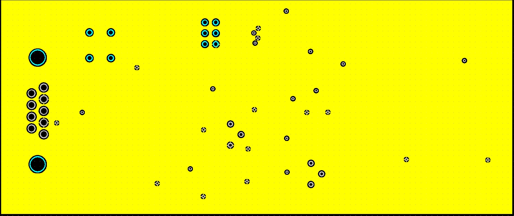

Sorry for the delay. I wasn't able to get a PDF generator so I have attached jpegs of the layers. It is a 6 layer board and the layers are as follows
1 - Top Signal Layer
2- GND Plane
3- Power Plane (+5)
4- GND2 Plane
5- Unused signal layer
6- Bottom signal layer
Planes 4 and 5 are not necessary so I was going to convert this to a 4 layer board. Please let me know if the images are adequate. Thanks for the help.
Top Layer.jpgLayer 2 GND Plane.jpgLayer 3 Power Plane.jpgLayer 4 GND2 Plane.jpgLayer 5.jpgBottom Layer.jpg

Looking at your board from a power viewpoint, I would suggest the following:
Your thermal reliefs are very thin. I would flood over all vias and either flood over or increase width of power connections at a minimum.
Use multiple vias for connecting higher current to ground/power. Unless you are using heavy copper (>2 Oz) your vias will be plated with less than 1 mil and will get hot.
Power traces are thin for 2 Amps. Judging by component pad widths, this would be rated for 1.5 Amps max with 1 Oz copper. Fill in the outer layers, the less copper you remove the better. Flood with ground where there are no connections, this will help with heat dissipation and shielding.
ICs U1, U2, U3, and U7 look like they would route better (shorter) if they are rotated 90 degrees counter-clockwise. U8 looks like 90 degrees clockwise would be better.
I would also add bypass capacitors to each IC and add some bulk capacitors to the board.

Flood and pour are commands used in PCB design by many CAD software to instruct the software to automatically fill in the open areas.
In the attached image ground was flooded, after routing, to fill in and around the existing traces and pads.

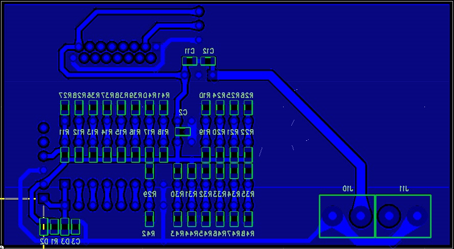

I agree with kubeek. The 150uF cap should not be there. Putting caps on the output of opamps can actually lead to oscillation (when there otherwise wouldn't be). This would normally happen with a lower ESR cap though.
Also, the si2312 is in a bad position, and you could move it to between the 0.6V reference and GND, to reduce the reference to 0V and maintain the regulation loop. You won't need the 200 ohm resistor. There is still the chance of oscillation caused by driving the IPB0... FET gate capacitance, so connect a small series resistor between the opamp output and the gate, perhaps 47 ohm.
You don't need the lower two inverting opamps; just a single opamp will perform the regulation task fine.
You should also put a small capacitor (10-100nF) across the MAX6006. Also the decoupling caps near the ATMEGA as mentioned above.
You should be able to do all this on your existing PCB.

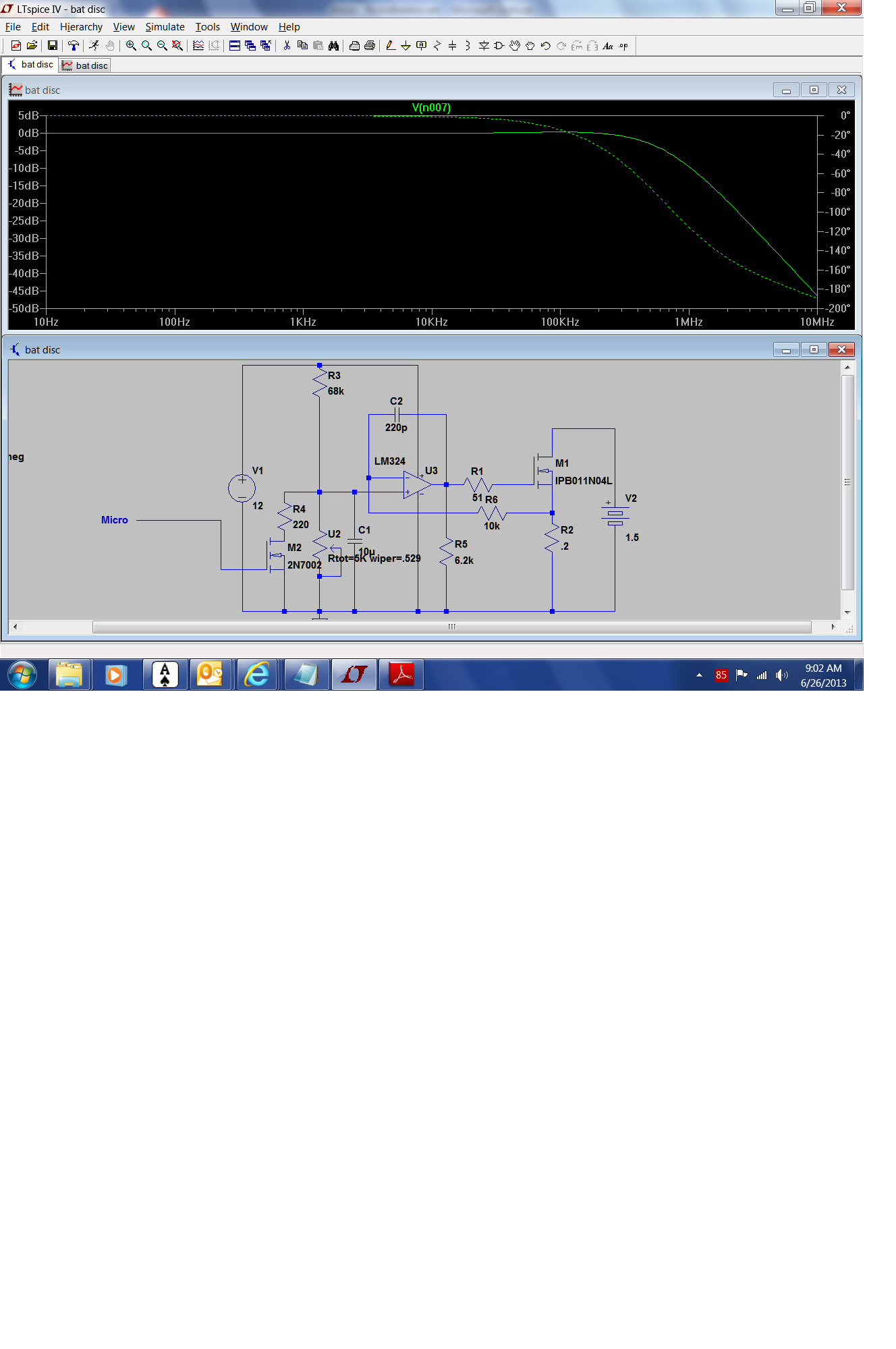

The circuit looks overly-complicated for a PWM-controlled current sink to discharge batteries.
Here's a simpler version:
Battery load
Here is one with all the suggestions. It has the compensation Dougy talked about so maybe it won't oscillate. Also a different op amp. Are you really using the IPB011N04l?
Hello CapeCAD,
I've seen this before on boards before but I never knew what the purpose was. I still don't actually. The feature is available in the PCB layout software I use (PCB Artist). Would you be able to explain how cooper fill areas affect the performance or help the pcb? Is it standard practice to use copper fill areas on the signal planes?
