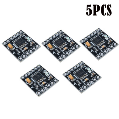

You could try a DRV8833 with both sections connected in parallel?
You can get small PCBs with them very cheaply on ebay, amazon etc.
eg.
