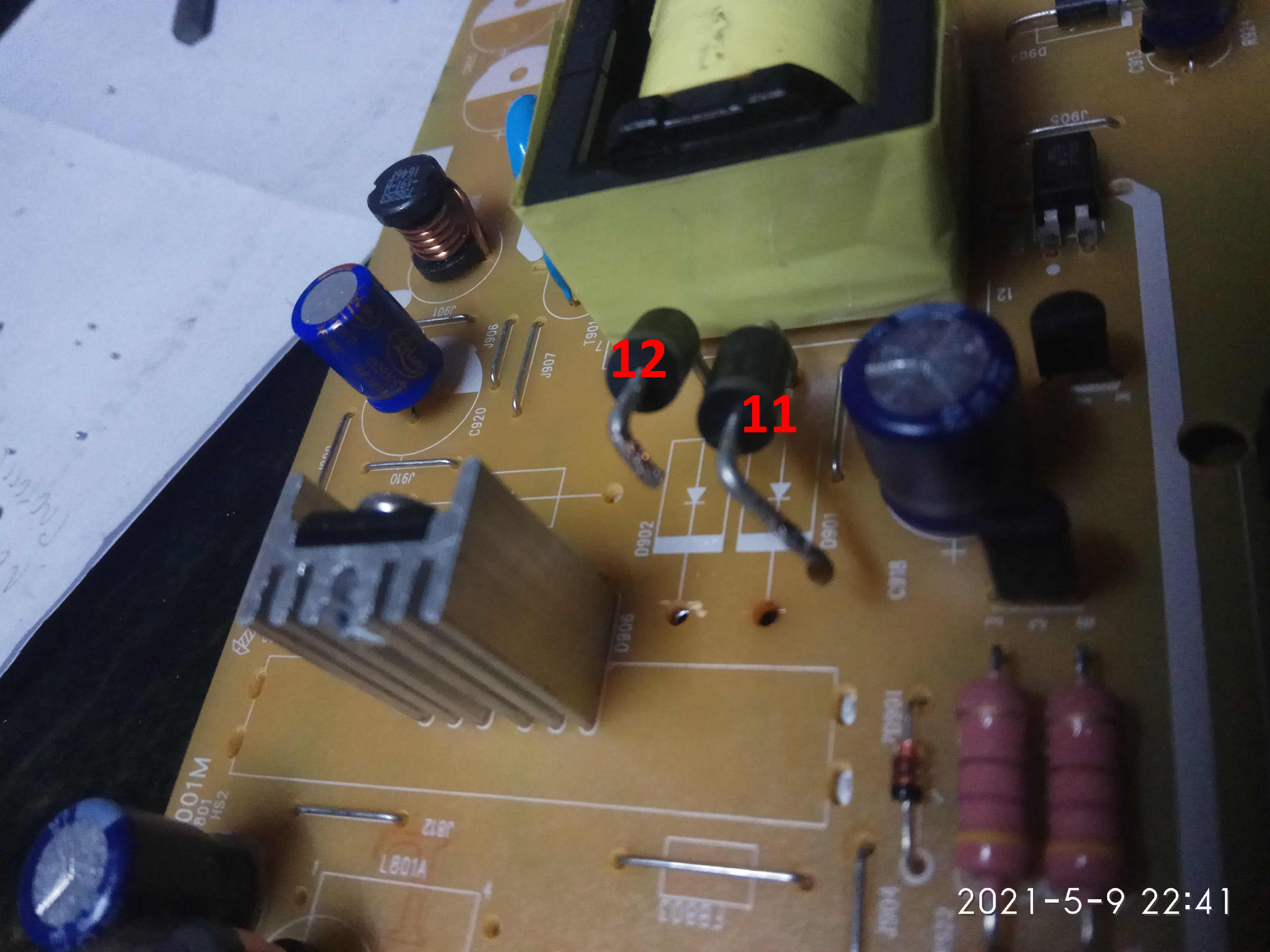

After all this time, I finally got the material to try and desolder the diodes so I could test them, but I f***** up and broke one of the legs:
Even after heating the joint for a long time and using braid I was unable to remove. The leg broke after I tried removing it with a plier.
On the diod with the leg removed, testing with multimeter in diode mode, reading is 362, if I reverse the leads there is no reading.
I don't know how the hell I'm going to remove these diods from the board, anyone has any tips?

It's absolute child's play - you simply melt the solder on the bottom and pull the wire out of the top with long nose pliers. Generally I would push the wires through from the bottom first, with the soldering iron, as they often go through quite a long way. You don't need any kind of solder wick or desoldering tool.
The wires are thick though, as are the PCB tracks, so you need a fairly substantial iron, a 15W one with a small bit probably wouldn't do, and a 45/50W temperature controlled iron with a medium/large bit would be much better.
Or - simply cut one end of the diodes to test them - like the broken one, you can solder them back together on the top afterwards (the crimp in the wire stops the end falling through).
If you can remove the broken part of the leg from the hole, that diode will still fit, it will just be a bit lower to the board (and look a bit crooked).
Those diodes seem to be 5A types, SR515
Your meter reading seems to be correct, and I think both diodes are in parallel. Try reading the other one in-circuit while the first is still disconnected.

OK, so I finally did it, had to swap to a 60 watts iron, but it still took a lot of time:
multimeter in diod mode, both diods with one leg out of the circuit:
Diod 12 reads 358, when I reverse the leads reads 1, (I don't think it gets any reading)
Diod 11 reads 002, same thing when I reverse the leads
Diode 11 is dead then (shorted). Good diagnosis, finally. Try to find a replacement. Replace both diodes at the same time, just to be sure.

VERY unlikely - the two diodes are in parallel with each other, a SERIOUS design flaw, which means they WILL fail, it's an incredibly common fault among the cheap and poorly made TV brands. It would be a nice idea to fit the required current balancing resistors while you're doing, or at least ensure that the diodes are well matched - use ones out of the same packet.
Can you explain in more detail about those balancing resistors? How to install them, and which ones to buy?
