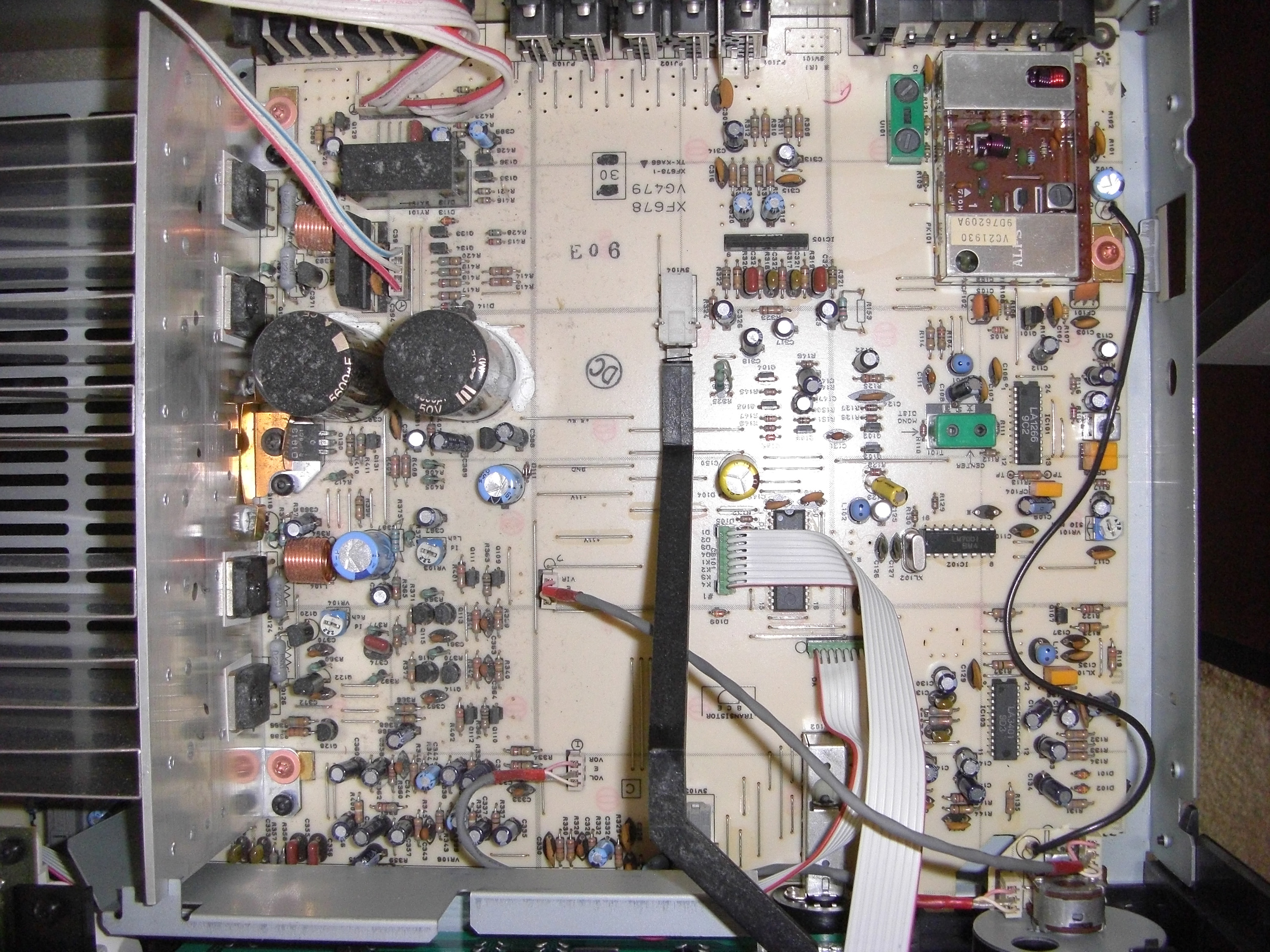

part needed for the yamaha RX-330 stereo receiver.
First impression is that the switch is a special that is screened for minimum hum and noise pick up. Can you see any way to remove the metal can around the switch to allow access to the contacts, or is the whole thing one piece?
It's a fairly 'normal' Japanese style slider switch - almost certainly a custom one made for that model - it's not particularly 'screened', the metal is simply part of the switch, and what holds it all together.
It's easy to squirt a little WD40 in there, no need to remove anything.
Well it is about 50 years since I did that sort of thing... but I still have the tools!
Looks like I need to un solder it whether I link it or clean it!

Yes, do give it a try.
What it is the worst thing that could happen? If the switch is ruined, bridge it for the most used input and continue enjoying your vintage equipment.
Could you also a larger image of the motherboard?

will this do?
do you guys thing I can remove the switch cover to clean the contacts.
without removing the circuit board.
yes it would destroy the cover.

Thanks for the photos
Very Japanese design. Well laid out board for effective auto insertion equipment.
Sanyo ICs, Toko coils, Alps tuner.
