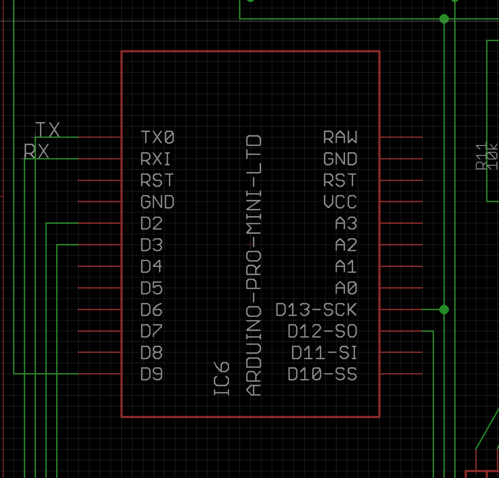

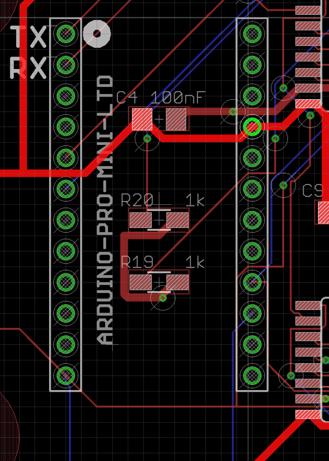

A pcb for 24 inputs and 48 outputs (using serial-to-parallel and parallel to serial 8-bit registers) is working flawless with its controller program.
Now I also designed a 72 inputs (72IN) board using 9 8-bits paralle-to-serial-8-bit registers based on the pcb 24IN/48OUT concept.
I adjusted the program accordingly yet this does not work. To prove that my program is ok I modified that program to work on the 24IN/48OUT pcb, only reading the inputs: that works well.
I then tested my modified program on the 72IN pcb and again not working (not reading the 24 first inputs).
So to me that proves there is an issue with the hardware of the 72IN , and/or its combination with my 72IN program.
Attached are the schematics for the 24IN/48OUT pcb and the 72IN pcb. I am at my wits end (cannot see the forrest through the trees) about this so I decied to post my question on this forum.
Please have a thorough look at my schematics, and any pointers, hints, .. are welcome.
Erik
Below here is my code for the reading of 24 inputs ony:
(EDIT: which does work on the 24IN/48OUT pcb but not on the 72IN pcb)
Erik
