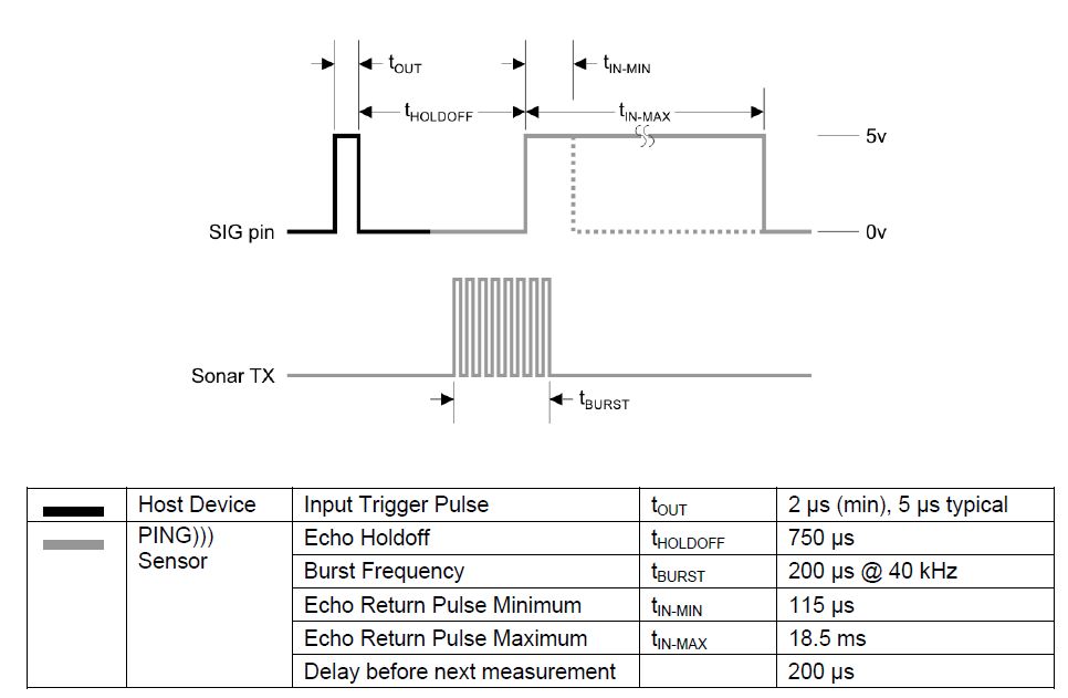

Hey guys im trying to use this Ultrasonic Ping Sensor from parallax but to me the documentation is all wrong.
https://www.electro-tech-online.com/custompdfs/2009/09/28015-PING-v16.pdf
If you look at the below image from the manual you can see tBurst.. Looks like a normal pwm style data coming from the sensor.
But in reality its a single long wave. (solid high)
ping-jpg.33420
I have some code to get the numbers but i know it has to be wrong because im never right the first time.

MyPing variable show contain the length of the high pulse ... but how do i convert that to CM? or better yet Inches?
This module supposed to work from 3CM to 3M

To get the conversion factor you have to know how many timer ticks you get per second and the ping boards conversion factor from detected distance to output pulse time
Using while(PingIn) MyPing++; may result in different times if you change compiler optimizations or the compiler changes or you get an interrupt etc
tBurst is the length of the ultrasonic transmission. If you scope the pins on the transmitter, you'll see that pulsed waveform for 200uS at 40kHz

Why not consult the documentation? - here's simple BS1 code to read it.

One common device that uses PWM input like this is the Parallax ultrasonic sensor. These sensors return a pulse for a length of time equal to the amount of time it takes sound waves to travel to an object and bounce back. Using some simple arithmetic, if we know the speed of sound and if we know the amount of time, we can calculate the distance of the object.
