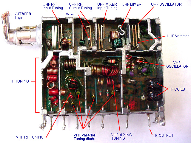

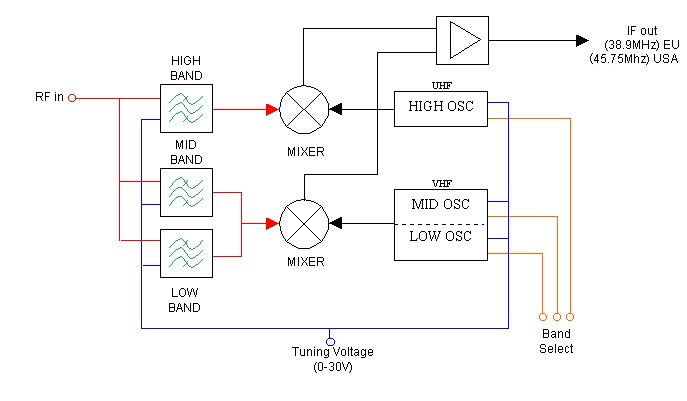

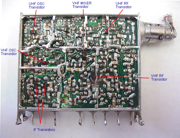

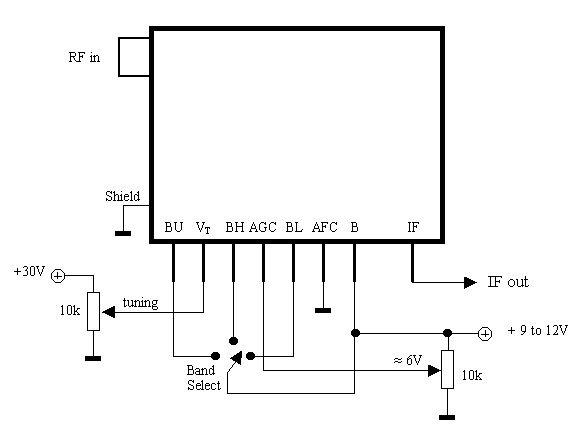

I'v attached below TV tuner diagrams. Does anyone know how to get the tuned frq. from the tuner to a displayer

Did I mess something in the post as to what you are planing to do with this if it works?
What purpose or reason do you feel you need to be able to collect such information on or from TV sets for?
Just curious.
