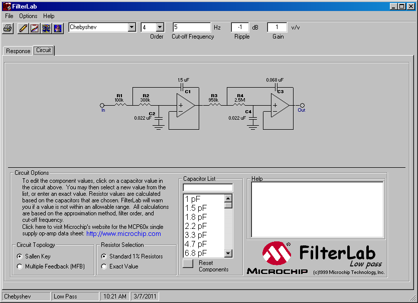

Ok, so go with an Current sense amplifier like **broken link removed** or similar parts from Analog Devices.. or my personal favorite, a ZXCT1009 (Edit: Upon further thought, the Zetex part may not work right at 3.3V?)
Follow it up with a 2pole to 4 pole active low pass filter (cutoff freq of ~10Hz), or a low pass combined with a 60Hz Notch Filter.
Typical filter:

It says it can be accurate down to 5uV which I believe is just slightly lower than my expected voltage drop on a 10 ohm at 0.6uA (6 uV) but I don't so much need accuracy down there, just to be able to detect when I'm in that state without having noise issues from the probes themselves doing their ambient ripple thing. This probe also has a selectable filter too which should help with my 60KHz "FilterVu" needs, but I may not even need that if this probe will naturally amplify the measured signal so I'm not actually trying to scope 5uV and filter it from probe noise but rather I'd be measuring a much higher proportional signal scaled up, but having both is good.
Any thoughts on using this probe for a sense resistor high side measurement?
I thought you wanted to get rid of 60Hz artifacts, not 60kHz. That differential preamp should work. Try it at 100Hz cutoff.
