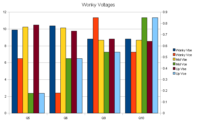

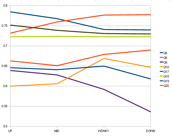

So far here's what I notice.
. Q5/Q6 voltages mirror each other fairly well
. Q19/Q20 voltages remain fairly constant and similar to each other
. Q9/Q10 sort of mirror but not very well

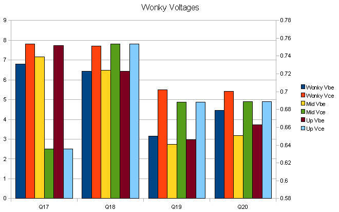

. There is an odd change in Vbe on Q17; otherwise, Q17/18 also appear similar and relatively constant
. The fact that the wonky trace dies down over time suggests to me an oscillation that is slightly damped
. Even Q14 and Q16 have some AC across C-E which I think is really interesting.
. With trace UP, there are voltage problems on the ref voltage, at C25, as well as Q11, Q13, and to some degree, Q17 Vbe.
. Several transistor "pairs" don't mirror each other correctly: Q13/14, Q15/16 ... we can't tell about Q11/12 because we need Q12 measurements.
The reason I want to rule out (or discover) problems with VR6 is because it seems the circuit is unbalanced and the transistors that aren't balanced/mirroring each other (#7) seem dependent on VR6 in some way. Q17 Vbe, Q13/15 Vc, Q11 Vb, Q9 and Q10 Ve.
