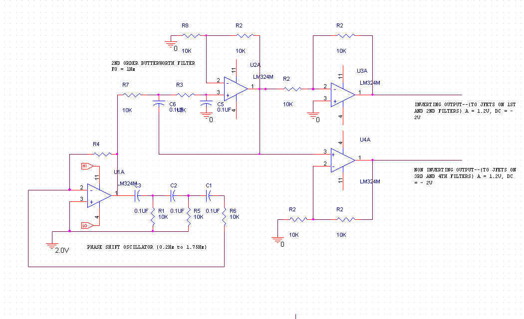

Hi, I am designing an oscillator. The output voltage will control the resistance of 4 JFETs.
This is the first thing I've ever designed really from scratch, so if its totally a horrible design you should say so.
**Anyway I don't have the values all picked out yet.** The values listed for all of the components are simply a product of copy/pasing. I pretty much would like to see if this idea is feasible before I start really getting into it. I have however, done some basic testing in PSpice and the results are promising.
I used a filter on the output of the phase shift oscillator because I need the signal to be smooth, but I also need a fast set time. I can achieve a fast set time with a big Rf in the phase shift oscillator circuit, but the output signal is very distorted. I used the filter to attenuate the harmonics. It works nicely, according to Pspice.
The JFETS I'm controlling will have gate voltages between -0.8 and -3 volts. I used the pair of inverting/noninverting amplifiers like I did because I want 2 of the JFETS to be at -0.8 Volts while the other two are at -3 volts. I hope this makes sense.
Right off the bat I'm pretty sure I can knock out one of the op amps by using a Chebyshev filter. The butterworth filter cannot provide a gain of less than 1, and the output from the PSO is always of a greater amplitude than needed (maybe I can power the PSO's op amp with less than +/-15 volts). THe trouble is is that I'm not all that good at designing Chebyshevs.
Also, I hvae the following problem: The magnitude of the output of the filter changes as the PSO changes with frequency (as in 0.2 and 1.75 Hz). I can't think of a good way to regulate the peak voltage, so I think I'm just going to make some comprimises.
Thanks for reading this!
and thanks for your help!

What's the purpose of this circuit?
It's helpful to show us the bigger picture as you might be doing this the hard way.
How are you going to change the frequency of your oscillator? It needs 3 capacitors or 3 resistors to be changed at the same time.
You can't use a Chebychev filter because its output changes in its passband.
Of course the output from your Butterworth filter changes when the frequency changes, it is attenuating frequencies above about 0.2Hz.

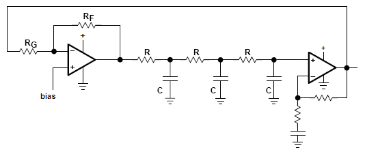

Your phase-shift oscillator uses differentiating filters. Why not swap the Rs and Cs to make them integrating filters? Then they are a 3rd-order lowpass filter that reduces the clipping distortion from the first opamp. Use a second opamp as an amplifier and buffer.

Hi, thanks for your help.
audioguru--I will try this oscillator circuit. I've never really learned anything about oscillators, and the one I used was copied straight from a book. Thanks for the tip.
It is preferable to adjust all 3 resistors or capacitors in tandem to change the frequency, but I'm quite sure you can do it by adjusting just one.
Hero--The whole project is a phaser. https://en.wikipedia.org/wiki/Phaser_(effect) I will be using this LFO to vary the poles of the all pass filters.
I'll be using this all pass filter design, except I'll replace the R with a JFET so that I can control the pole.

btw, back to the original topic, I switched from the phase shift oscillator to a wien bridge oscillator. Much less distortion.
