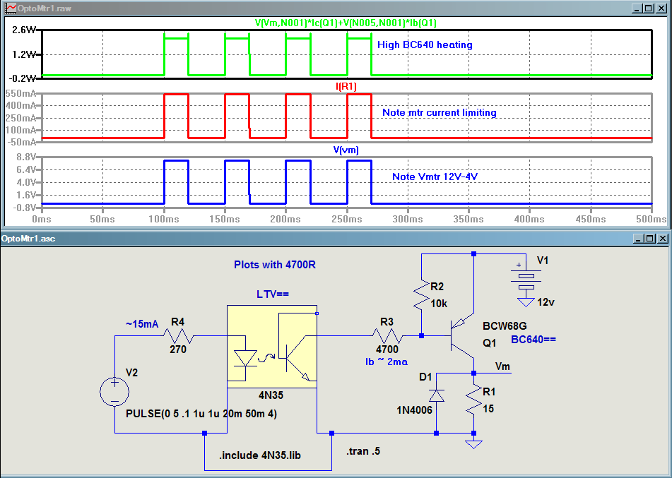

A quick run of a LTspice simulation of your existing circuit shows the BC640 dosnt saturate and dissipates about 2 to 3 Watts!

Basically the opto cannot drive the base of the BC640 hard enough to fully saturate it.
I would have chosen a P MOSFET, not a transistor. If thats not an option. you require an additional transistor between the opto and BC640.

The reason for only approx 2mA to the base is the 4k7 resistor.
Say you have a Vbe of 0.7V for the BC640 and a Vsat for the LTV, approx 1V say.
Then [12Vs-1V]/4/7K = 2.3mA..

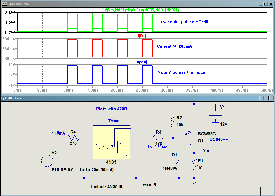

You could try reducing the 4.7K to about 470R thru 1K, this will give approx 23mA thru 11mA.
Choose a emitter drive resistor to give 10mA to 15mA thru the emitter diode.
Check that the drive voltage across the emitter is less than +0.6V when in the off state.
The typical LTV827, CTR for 10mA/15mA drive is 150%.

EDIT: couple of sims to show the effect of under driving the transistor. Used close equivalent types.

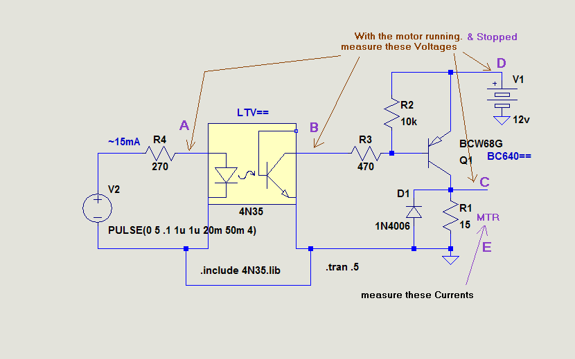

OK,
Read the post results.
Look at this image and measure the points marked and post what you find.
BTW: for info only every post has its own serial number.. on the righthandside.:)
