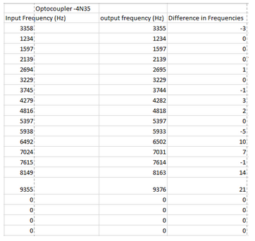

I have a question and this time it is about the cascaded system (V-F converter + optocoupler + F-V converter + a noninverting amplifier - gain of 2, + a lowpass filter).
This is what I had when I applied dc offset to my system so as to check its linearity:

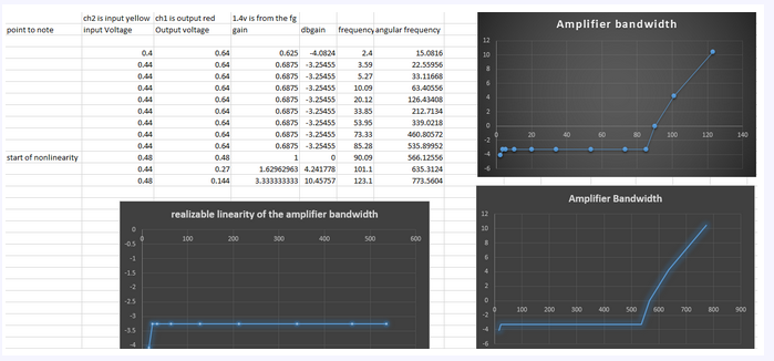

However, when I included my ac signal, I had the following response:
The above frequency response should resemble a low pass filter. I do not know why I am having such response. Thanks in advance for your feedback

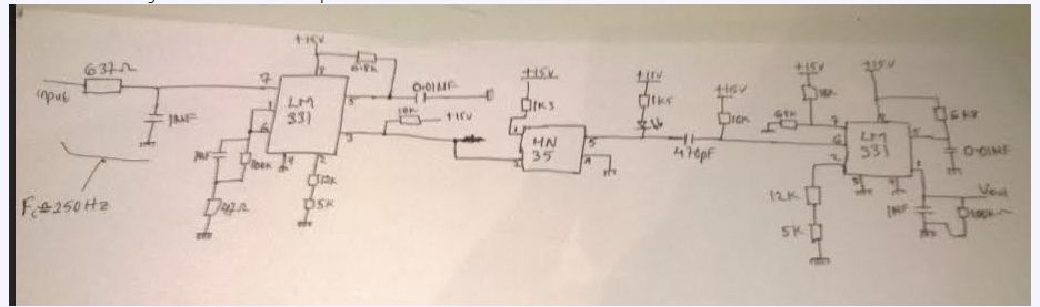

Circuit diagram for the above frequency response:
Thanks. But what is wrong with this configuration? They work respectively. The only challenge now is that I was unable to make them work together. That is where I need assistance with at the moment. Thanks in advance.

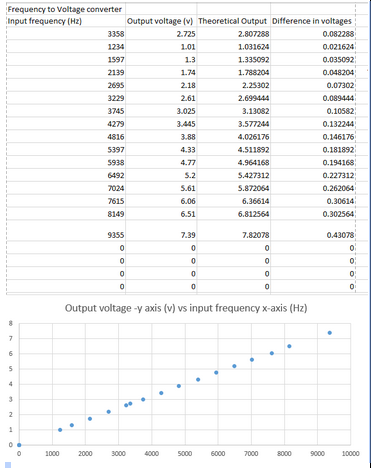

There is insufficient debug info with your results.
Connect both circuits and verify transfer function of each component.
Does V>F work?
Is pulse sufficient into F>V ?
Does F>V work?

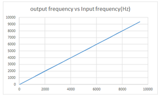

Thanks. But the main reason why I am using the V-F is for the linearity so that the optocoupler's nonlinearity doesn't affect the signal

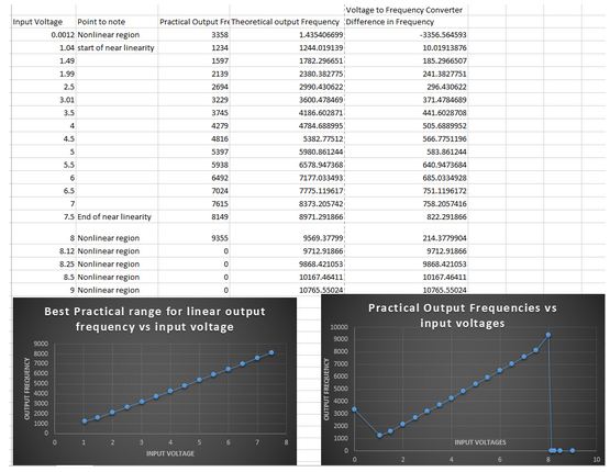

Also, how do you calculate the threshold voltage of the stand-alone V-F converter? Is the cutoff frequency for it calculated theoretically this way: fc=1/2*pi*Rt*Ct ?
Is it true that the circuit could work for very low frequencies? It seems not by the response of this circuit. I did not just know why I got that kind of response.
The V-F circuit [of the LM331 - https://www.ti.com/lit/ds/symlink/lm331.pdf] on the datasheet suggests that its linearity ranges from 10Hz to 10KHz. How can I adjust it so that its linearity ranges from at the least dc to 250Hz?

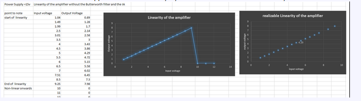

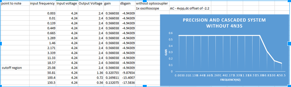

Thank you very much for your swift and helpful response. I have been able to cascade the VFC&FVC (LM331) together and got:
The above cutoff frequency (25Hz) is too small compare to what I need at the time. The cutoff frequency should be up to 100Hz minimum. What component can I alter in order for me to get this cutoff frequency?
