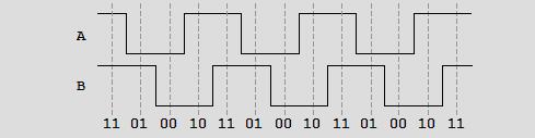

Yes, it goes back to 01... As Philba mentioned, it's a repeating pattern of four values that the encoder moves through in either direction... As mentioned earlier, one method for determining encoder direction is by exclusive or'ing the A or B bit of the last encoder value (my ENCOLD var) with the opposite bit of the new encoder value...
If the old encoder position was AB=11 and the new encoder position is AB=01 (moving to the right in the graph above), then the direction is '1' (B_old^A_new=1^0=1)... Save the new encoder position '01', use the direction bit to branch to your increment speed or decrement speed code, then wait for another encoder change... If the next new encoder position is '00' (another move to the right) the direction will again be '1' (B_old^A_new=1^0=1) and if the new encoder position is '11' (a move to the left in the graph) the direction will be '0' (B_old^A_new=1^1=0)...
Pick any spot in the graph above as your old encoder position and then pick a position to the left or right as your new encoder position and work through the B_old ^ A_new logic (^ is the "exclusive or" operator)... You'll always get a '1' when moving the encoder in one direction and a '0' when moving the encoder in the other direction...
Philba mentioned that the "exclusive-or" code might be a little difficult to understand for a newcomer compared to "table" code but he didn't post a code example... I've always found table code examples confusing but I suspect either (or any) code method might be difficult for a newcomer to grasp if you don't have a good understanding of the quadrature AB signals...
Good luck on your project... Have fun... Kind regards, Mike
<added>
BTW, which PIC are you using? What oscillator/frequency (INTOSC, XTAL)?
