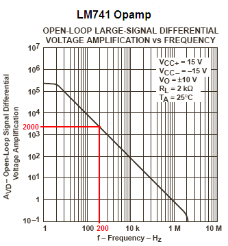

With a gain of 2000, an old, old 741 opamp will have its output full of noise like Dknguyen said. Its frequency response would drop above only 200Hz. A modern wide bandwidth opamp like a low noise TL071 would still reduce the output above only 3kHz.
Two stages each with a gain of 45 would be able to reach up to higher than 20kHz with TL072 dual opamp. The noise would still be audible unless opamps with extremely low noise were used.

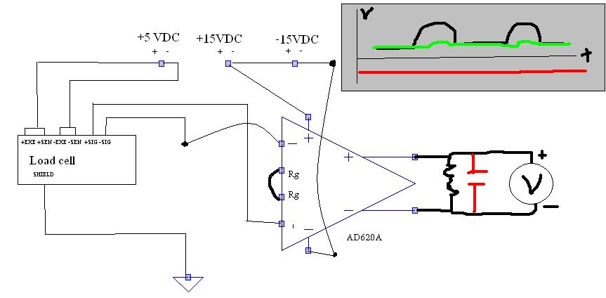

I have got a AD620A to amplify the output. But the inamp output wave form i get is a half wave sine. When i used a 741s to make a homebrew inamp, i also got a half sine wave i dun think its the load cells signal, but also i cant check, the schools equipment cant check the small signal. The output from the load cell seems to be riding on the half wave sine.
I think the noise is very high and the ammeter reading i get when not connected to anything are even higher that our load cell output. I was told by thet lab tech that the power supply's ground is not a true ground. So i did not ground the load cell. However, when i did, the output from the inamp changed, the half sine waves decreased in amplitude, and also the output will also turn into an almost straight line when i step on the load cell.
I also tried connecting a capacitor parallel to the load. But, the whole output turns to a negative and wont even react to the load cell output.
So how can i reduce the noise(im not sure if it is noise, but the amplified outputs have half waves, i am thinking of low pass filters but im not sure)? Also any comment on setting the gain for the device? Thanks.
Still no schematic for us to see.
Are the inputs from the sensor balanced and with a shielded cable? If not balanced and shielded then your circuit picks up mains hum.
Are the inputs from the sensor balanced and with a shielded cable? ?? Balanced??? The cable is shielded, and i connected the shield to the power sources ground. Then also theres still the problem with the instrumental amp...i can only get a 'following' output if i short it as in the diagram. When i try a trimmer or even a fixed resistor in between, it dosent work.
The top right shows the waveforms... black is when i do nothing. Green is when i step on load cell. red is when i try a capacitor across as in the diagram. I think its a polar cap.. but then even when i try reversed still the same.

I don't think AD620 is meant to be run open loop, which is what you are doing when you make Rg=0. A gain of 1000 (Rg~49) is the highest mentioned in the datasheet. With Rg=0, the gain is unpredictable (theoretically infinite).
AD620 does not have differential outputs, as shown in your schematic. Perhaps you think pin 5 is the output "reference"? Pin 5 should normally be grounded.
If you try these things and are still having problems, post your results here.
I tried using pin 5 as refernce for my load..it seems to be working. But the waveform looks funny. If like you say, i ground pin 5, then where do i get the reference for my load? I tried putting the load to ground. dosent work... Or do i make a own reference with some voltage divider or just loop it from the load cell reference?

The output of AD620 is referenced to whatever is on pin 5. This could also be the reference to your load. As long as this reference is between the two power supply rails you provided ot the part, there is no issue. when you say you grounded the load (also = pin5), and it didnt work, what do you mean?
Is your load that resistor and capacitor in parallel? (from your diagram)
What are there approximate values? Generally, you should not be driving very large capacitors (more than say 100pF)directly and the load resistor cannot be too small or the AD620 cant drive that either. If you need to drive a small resistor load (high current), you need to add a power stage.
Best if you elaborate on these points.
Also, I would suggest using a low noise inst amp as the first stage and put most of the gain (within reason) and then follow it by 2 or more low noise stages to get up to 2000. Bandwidth requirements need some calculations.
As a caveat, if Ref is not GND, it would not be advisable to connect a scope GND to it. If you left it floating except for the scope GND connection, it could account for the hum you are seeing. If you connect it to a voltage (why would you?), a scope GND could short out the supply.
