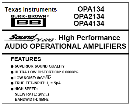

They take an OPA2134 opamp with 0.00008% distortion which is way below what anybody can hear, and they add a DC load so its output operates in class-A to reduce the distortion!
