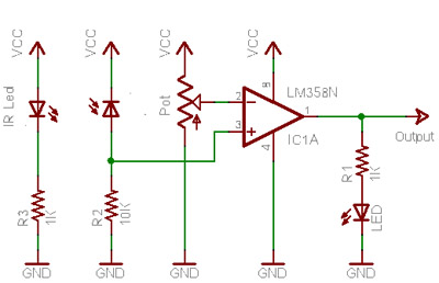

i am attaching a circuit .. please refer to it..
i tried it and its working perfectly for one ir sensor. now what my question is.. i require around 10-15 ir sensors for my application and that too have to fit it in as small area as possible.... i cant use an op-amp for each sensor... the thing is that only one sensor wil be active at a time.. so is it possible to connect all the ir sensors in parallel ?....
what will be the overall effect.. .i want the red led at the ouput to glow when any one of the ir sensor senses ir rays....
any kind of help or suggestion will be grate... thanks!

How is that the same circuit you have recently posted, on this forum and others, as not working, is now suddenly working???
Audioguru has already told you about the problems with your circuit.
ya thats true.. initially it was not giving proper results.. but that was due to my mistake.. my bread board was not proper.. when i soldered every thing on the pcb it jumped to life... i dont know.. you may be right. but the thing is ..its working..

The problem that you will have with 15 light detectors connected in parallel will be the dark current leakage and the detector current due to ambient light.
You say you want 15 detectors, are these close together or spaced some distance apart?
What exactly are you trying to do
