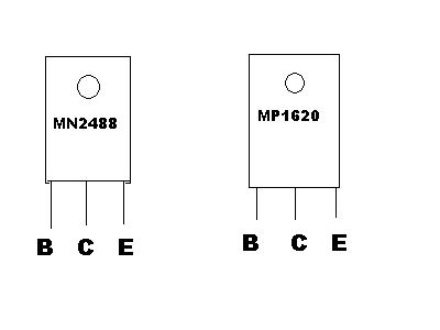

A little more interesting when measuring the resistors when powered. I turned on all 5 channels on the amp and each dropped to .4 omhs except for R576. Don't know what it means, but at least it's different. From my reading of the diagram, this is for the right channel which is the problem one.
Does this mean that R576 is faulty, or that something leading to it is faulty?
You should NEVER attempt to measure resistance whilst powered, you're likely to kill both your meter, the amp, and get no meaningful readings anyway.
I'm clearly showing my lack of knowledge.
Thanks for the advice, I'll not do it in the future. I don't think I caused any damage though this time.
just curious, what is R576? if it's a ceramic resistor, and it gave you a different reading than the others like it (even though you shouldn't measure resistance with power applied), then something is different here. i would measure the voltages across those resistors with it powered up. R576 is the emitter resistor for the output transistors in the Rch. this tells me that it's R576 and the output transistors, and their associated components you should be checking. one of the output transistors could be bad, or one of the 180 ohm resistors feeding the bases of the outputs. Q554 and Q555 aren't likely to cause distortion, but if there is a problem with the output devices, it's likely one or both of these transistors is bad too. with the POWER OFF. use the ohmmeter in diode check mode to test the 2 power transistors. the picture shows the pinout of both devices. on the MN2488 from B-E and B-C you should read open with the negative (black) ohmmeter lead on B, and you should read low resistance with the red lead on B. from C-E you should read open with the red lead on C, and you MIGHT read low resistance with the black lead on C. with the MP1620, you should read low resistance B-C and B-E with the black lead on B and open with the red lead on B. you should read open C-E with the black lead on C, and again you MIGHT read low resistance with the red lead on C. if all of these readings are ok, proceed to checking the resistors with the ohmmeter back in resistance mode. the ceramic resistor R576 should read less than an ohm end-to-end (meter leads have some resistance that makes reading low resistances somewhat inaccurate). R574 and R575 should read close to 180 ohms. when testing D551, D552, D553 and D554 should all read open with the red meter lead on the end with the stripe (make sure you return to diode check mode) and low resistance with the black lead on the end with the stripe. since we're looking first for the cause of distortion, don't worry about Q554 and Q555 yet.
do these checks first, since if you don't find anything wrong here, we're headed back to IC501, and static testing of IC501 isn't so simple, but we do have identical IC's near it to make comparisons with

I'm at work right now so can't check anything, but I can tell you that R576 is I believe a ceramic resistor. It's white, about 3cm W x 2cm T. The posts extend through the top resistor, presumably for testing as they don't connect to anything on top. I'll get the model number off them tonight.
On a positive note, I happen to have at my disposal a working unit which is exactly the same model. I borrowed it from a friend when mine stopped working properly. I'll try everything you suggested first, but at least there is some what of comparing.
you also have the other channels to compare against.
