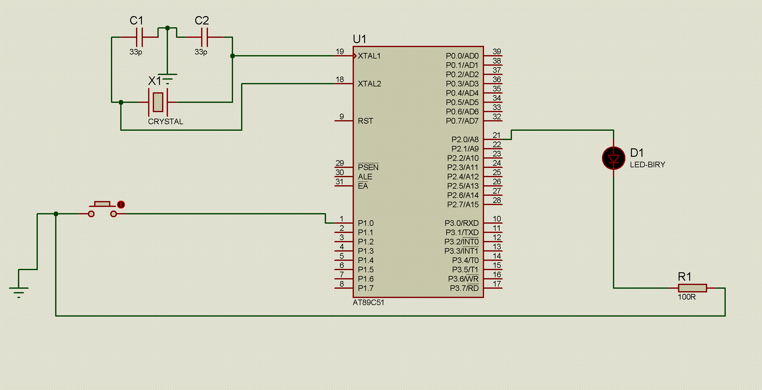

on off switch
atif123
i need a c code on keil . 89 c 51
At its crudest, you could start with
#include <8051.h>
void main()
while (1) // do forever
P2_0 = P1_0;// copy switch input to output
This will just copy the current switch state to the output and takes no account of switch bouncing.
