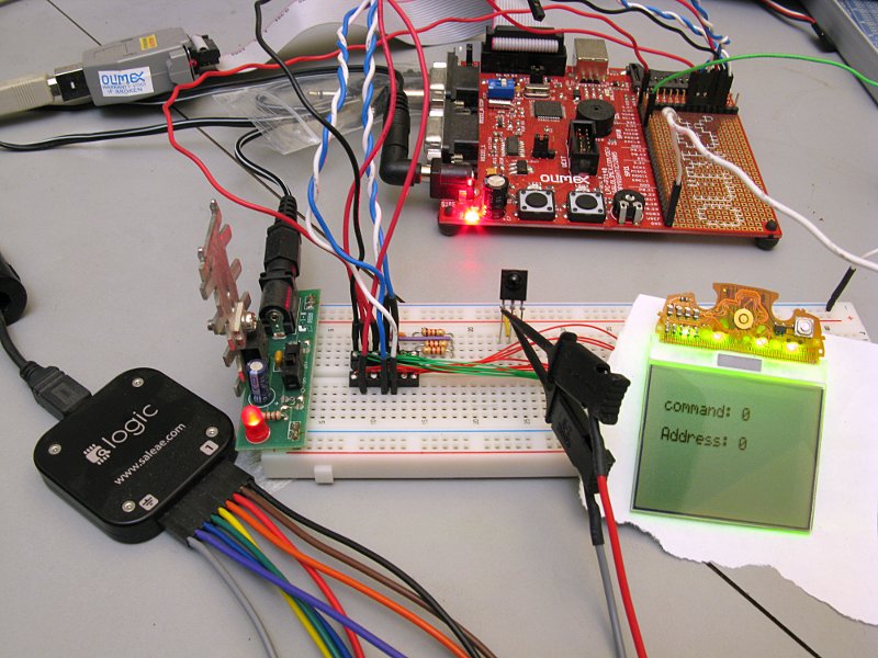

So I've been tinkering with remote control IR. I learned SIRC probably a year ago (you may have looked at to the same PNA4602M sensor and studied Pioneer codes until I understood them (my DVD player is a DV-578A). Just your standard Space-Width Encoding - LSB first, each byte repeated as a 1's complement byte for error checking. Then I looked it up and found that it's called LIRC.
Then I tried the same thing with my ancient RCA TV remote. But the 38KHz sensor doesn't see the RCA remote at all. Anyone know what carrier frequency an early 90's RCA TV remote transmits with?

Ya. Guess I'll have to rig an IR phototransistor and measure the pulses. I have some, but they look exactly like LEDs, so I think they're mixed in with them. Good luck sorting them out...
All those TSOP sensors need a filtered supply. A 100ohm resistor & 4.7uF cap are common. Just like the Junebug schematic shows.
Do you really think not having that filter would be enough to make the sensor completely ignore my remote? I would think that, at worst, it would work badly, but would at least see something.
With my Logic probes connected to the sensor, madly hitting buttons on the remote, I see nothing whatsoever. I've checked that the remote is working, both with the TV and by looking at it with the digital camera.
Without the correct decoupling they are often unstable, and don't work at all.

Ya... I don't really think that's it. Both SIRC and LIRC codes are detected perfectly every time by this sensor. I've looked at the sensor's output with the logic analyzer () many, many times and all seems perfectly normal. Nice clean pulse train. Only with the RCA do I get nothing.
That said, I'm going to add that resistor and cap anyway, just to see if anything changes. :p

why not connect the logic to the remote itself and test it to see the pulses it sends and calc from there?
I looked close and refreshed my foggy memory on the RCA remote. I guess I had had it apart before (to clean the keyboard) and it was pretty easy to crack it open again. Connected the logic analyzer to it and now I can see the pulses just fine. I'm calculating out the frequency right now... Yup, it's 56kHz. Guess the 38kHz sensor filters that out as noise...
Evidently, the sensors now being produced include a built in constant voltage supply, which negates the need of any external filtering. See this datasheet of a sharp sensor I recently used, and this datasheet of the PNA4602M from panasonic that he is using.
