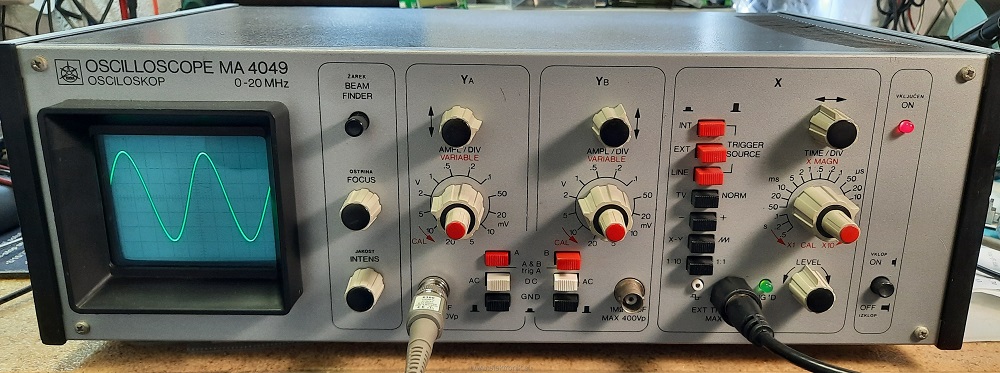

I got this analog, 2 channel 20 MHz, very old oscilloscope.
Problem is that Variable knob(sometimes called CAL on Tektronix) affects the vertical position of the signal beam.
I demonstrate it in the video
Any ideas where to start looking ?

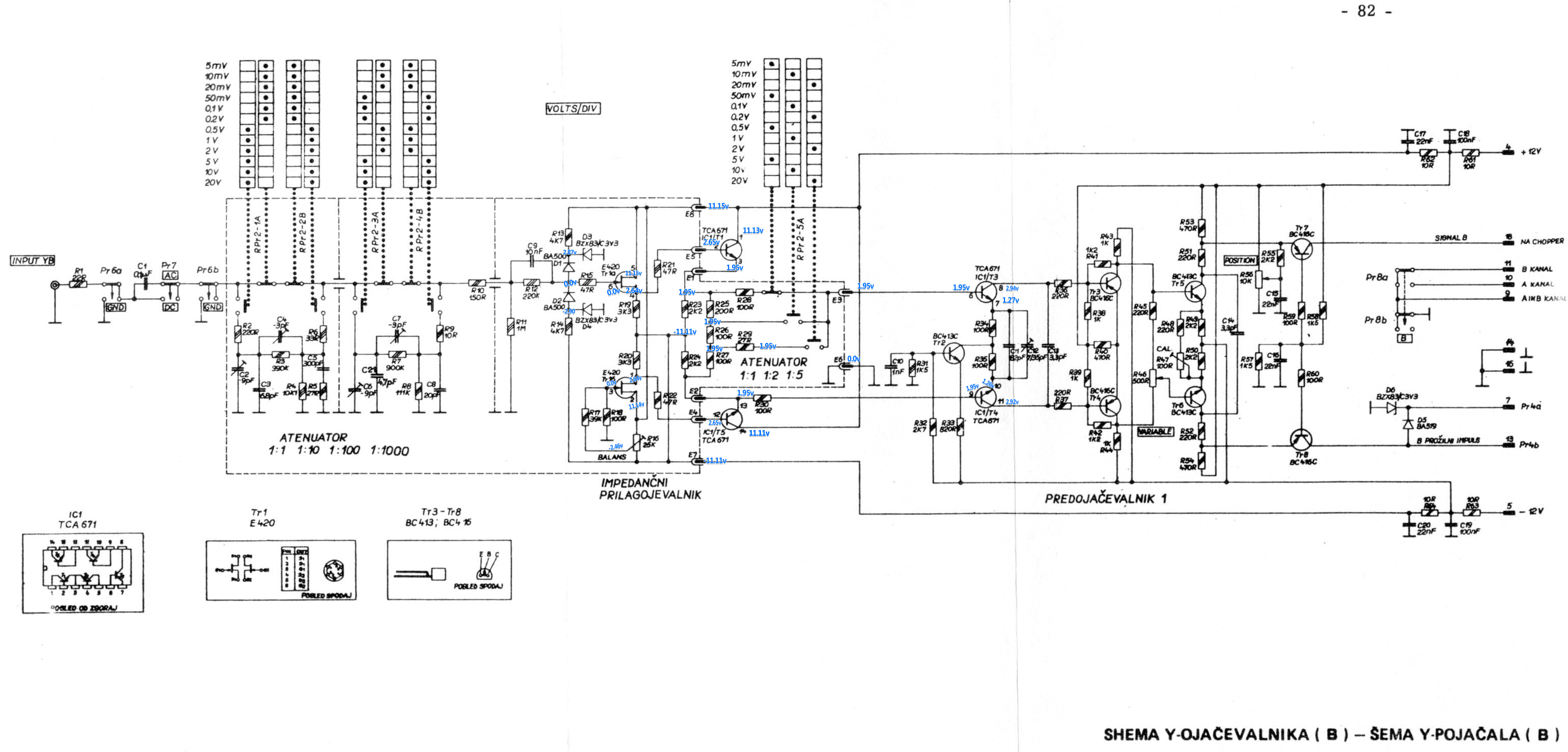

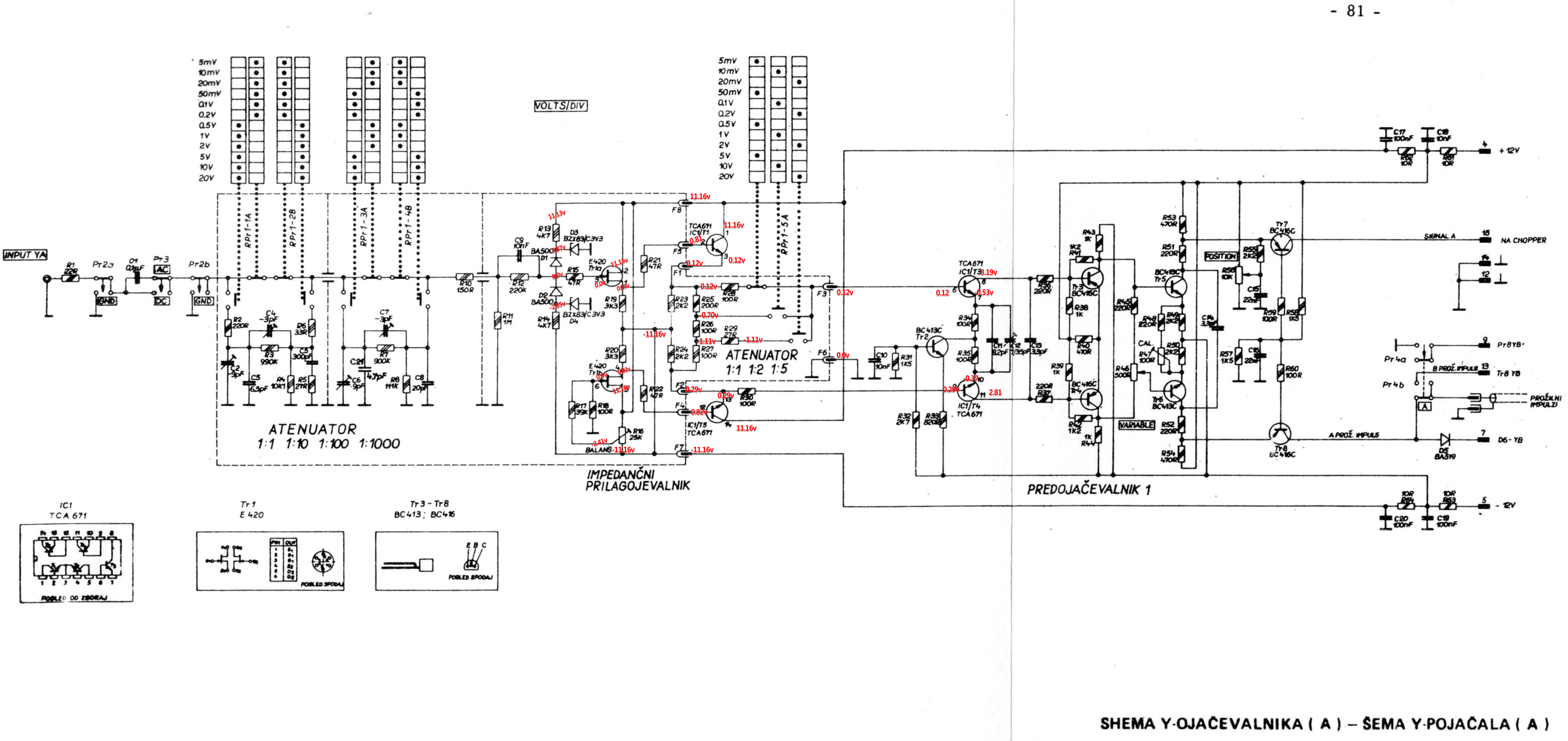

I did some measurements, can you spot which component is bad based on these voltage readings ?
Bad board A
Bad board A​
Good board B
Good board B​

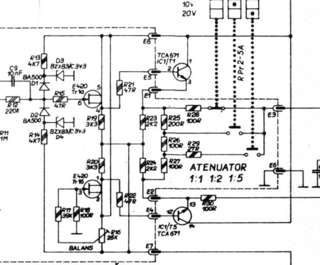

It looks like somewhere around R24 to R27, something is high resistance, shorted or a bad joint?
IC1/T5, the one below the 1 / 2 / 5 attenuator switch, has a different base-emitter voltage, compared to all the others.
Note that R25/26/26 have no voltage across them on the good channel, but a large voltage drop on the bad one, especially an odd voltage on R29.
It could be something in the switches even, corrosion or dry joint?
I suspect something in that area is messing up the voltages at the transistor.
