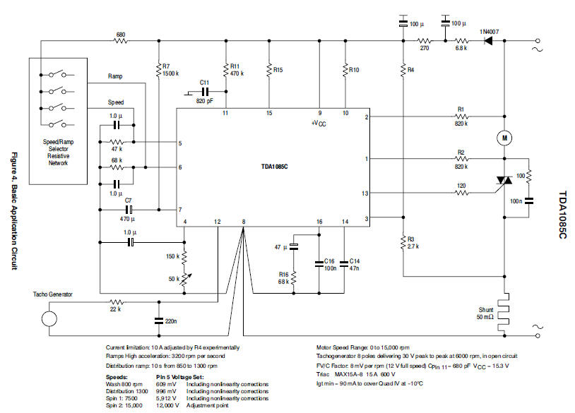

See the first schematic in this thread for the concept it likely uses:

The one below uses the same concept, but a different IC; in that, the feed resistor is 6.8K
12K is not unreasonable, if yours uses a bit less current than this, or this is a 115V one; it's not clear from this diagram..

The TDA1085 was developed by Motorola specifically for washing machine using a Universal motor.
It does have to have a simple low-res tach on the motor however.
