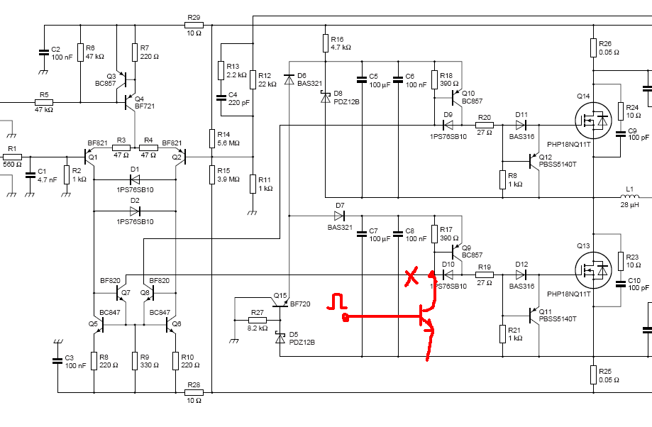

a few things:
1) that 1n4148 is likely fried. something like a 1n4001 is more appropriate.
2) .1u for 2khz swithching may not be enough. you should go through the calculation to make sure that .1u works, as well as a 1n4148 works - if the charge-up current is too high, you should put a serial resistor with the 1n4148.
a couple observations about the driver:
1) the gate is being charged up through a 1k resistor: that's fairly large considering that the gate capacitance is likely over 3000p for irf540.
2) there is no way for the gate to be discharged.
so the combination means soft turn-on and soft turn-off of the mosfet -> large power dissipation.

I don't know but it may not work at high speed (then 2khz isn't too high), and you lose the driver voltage.
take a look at this schematic (from Philips). Q11/Q12 are there to bleed the gates. it should help you nail down component values.

Sorry I haven't posted any results of my testing sooner. With the help of several folks on the forum I have been running the H-Bridge successfully using the transistor and bootstrap style high side drive and also using the
IR2110 driver. I discovered that the bootstrap diode I was using (1N4148)was too light and not allowing the gate drive voltage to get as high as it should.(i.e with the 12vdc, the gate drive should have been about 10vdc above that or 22vdc). I switched to the 1n4001. I also discovered that the bootstrap cap I was using (.1uf) was not large enough. I'm now using a 1uf bootstrap cap and am getting a solid 22vdc gatedrive voltage. The fets are not heatsinked yet but I can run them close to 3amps without getting too hot to touch(about 130F).
I also discovered that you can increase your gatedrive voltage easily by increasing the size of the bootstrap cap, however when I used a 10uf cap, I was getting around 32vdc gate drive voltage until something happened to the IR2110. The specs indicated that Max Allowed gate drive voltage would be your Battery or supply voltage plus 20vdc that put me running right at 12+20 or 32vdc which burned out the IR2110.
My next step is to add radio control capability and then create a double sided board with enough copper to support the 30amp fet capability. Would appreciate anybodys recommendation on a good system for making your own double sided boards.
Thanks, John
Put 18v zeners on the gate-source of the mosfets. They will drop any transients to the gate, which there always are spikes using a bootstrap cap.
Also put a 100pF ceramic cap between the drain and source of the mosfets. They will reduce the turn-on and turn-off ringing that occurs. Another source of failures.
Don't use any resistors between the drivers and the gates themselves. Mosfets do not need to be current limited at all, and it just slows down the switching speeds.
H-Bridge
Thanks for the advice. You are right, I am seeing a lot of ringing when looking at the drain or source to ground on the scope and was wondering what to do about it. I will add the ceramic caps to see if that will help. And yes, I do have resistors on the input to the gates which I will be removing.
Thanks again,
John

can you post your final schematic? I am trying similar thing....
Latest Schematic V3
I'm sure there will be changes. I want to add thermal shutdown(or slowdown) by sensing the temp of the high side fet heat sinks.
  • Dual H-Bridge.pdf
You have 3.3k resistors in series with the gates of the Mosfets. Then the Mosfets turn on and tunn off very slowly due to their high gate capacitance. When they switch slowly then they get very hot.
The 3.3k resistors should be 10 ohms to 47 ohms to prevent the Mosfets from oscillating at a VHF or UHF frequency that will also cause them to get very hot.
What causes the oscillation? I have not run into this in any of my research and would like to understand it.
Could it be the turn-on/turn-off ringing of the drivers?

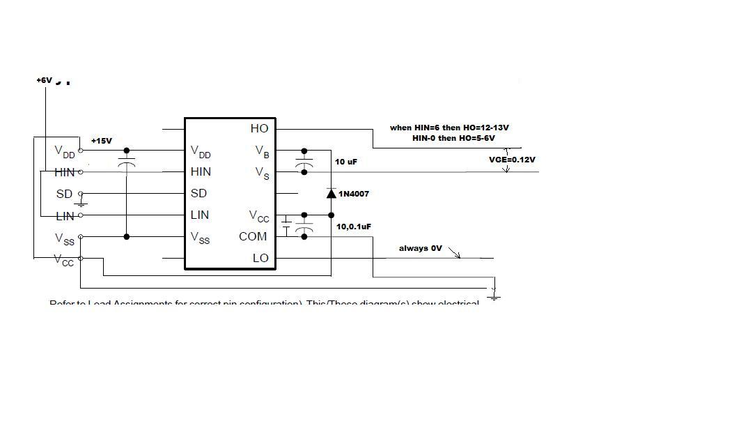

ir2110 testing???????
Can you please explain me how to test ir2110 IC...I don't understand what I get the results....here is what i have done....
To test ir2110, I just make this connection shown in the figure..
I have tested following cases...1. HIN=LIN= +5V, LO=0, Ho=15V
2. HIN=0, LIN=+5V, LO=0, HO=15V
3. VDD=HIN=LIN=5V, same results/..
why I am not able to get LO high ?...
Suggest me something I am restles......offffffffffff........
