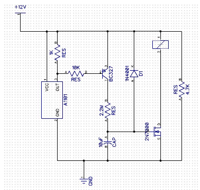

Here is my version. I do not like the one you posted, because it is overly complicated, and it takes too long to discharge the timing network if the power is momentarily interrupted. Mine resets in less than 1s. I intended it to be used with a 12Vdc relay that has a coil resistance of 100Ω or more. The parts cost per Digi-Key is less than $1 not counting the relay. If you need a longer delay, I would say that an upper limit on R1 is 4.7megΩ. C1 should have low leakage.
MikeMl, I know this thread is over 6 mth old but I was looking for a relay delay cct and the one you posted seemed suitable. I needed to vary it slightly to suit my application and had to use a 2n7000 FET as it was the only one I could get locally. BTW, the relay coil is 400ohms.
I built it as per the attached cct but unfortunately it's not working, and with my limited electronic knowledge I don't know why - hopefully someone may be able to tell me.
The output of A1101 is high and goes low when it's activated. BC327 is switching and providing 12v to the 2.2meg resistor, however the volts at gate of the FET begin to increase but only get to .67v and stop there.
What could be the problem?

If D1 is connected to GND instead of +12V, this could cause exactly what you see.
The next most likely problem is the CAP could be backwards. It's probably an electrolytic, and the (-) should be to GND.
Thanx for the suggestion. I was hoping it would be something as simple as that but no, everything was installed correctly.
I decided to put the diode across the coil and moved the anode from the gate to the drain. This got the circuit to work - it delayed the relay turning on by approx 5 - 10 secs. When it finally did switch on, it wasn't a "clean" switch, it seemed to take maybe .5 sec or maybe longer. Not sure if it would hurt anything, I just haven't heard a relay do that before.
