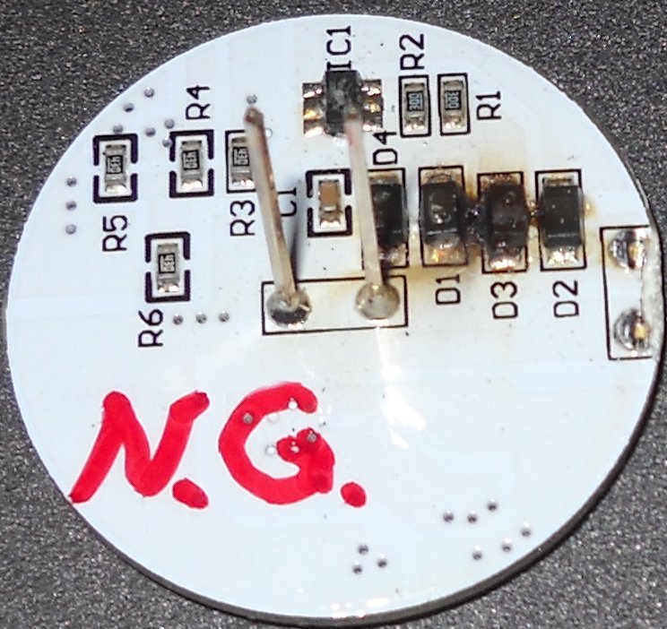

Not very happy with LEDs.
I checked one that was still working on my home transformer that puts out 31 volts but has big capacitors in it. (I don't remember the uf) It was drawing 65 mA and getting warm.

I tried them on 12 volts and they were very dim.
We are using 24 volt transformers but I put full wave bridge rectifiers on their outputs, just in case and to bring the 26 or 27 volts down a little. But that is well below the 32 VDC they claim.
All of the diodes have blisters on the clear coat.
The 6 pin IC is numbered 40??
Can you show the other side of the board too?
What is on the other side opposite those diodes?
Did you ever try replacing them?
SMD parts are a little different than through hole parts. SMD parts like diodes need a certain amount of copper real estate in order to function to the power level they were intended for. In fact, even some regular through hole diodes require copper board area to help dissipate the heat. Maybe they did not provide enough copper surface area.

This is a 1.5 kva transformer that I use for my CNC. I used 100 amp diodes to make the rectifier and the highest mfd capacitors that would fit in the box. The ones on the boat are 6" high & 4" square with a 7 amp fuse.
All just guessing though until we see the circuit schematic. If you can create one we can wrap this up, but if not it's guess guess guess from now until October :)
Somehow I think if I put better diodes in them or bypassed them altogether, (since we have DC now) they might be okay. Although 140 lights at $21.99 is a lot of money and so is 140 lights at $7.00 that we are going to replace them with, we consider them a fire hazard. The price here isn't all that important. Mainly, I am just complaining.:D
We are just guessing about what those diodes are for. The sales sheet says the LED discs are powered by DC and does not mention AC.
The diodes might protect the circuit if the polarity of the 24VDC is backwards.

True. But a single diode could do that. It's unlike a manufacturer to add extra components just for the helluvit. As you say, we're just guessing.
The diodes make the polarity right no matter which way you plug it in.
They work either way.
I did that on one of my products to make it fool proof.
You need to backwards engineer the circuit and make a drawing to avoid the wild guessing of how the circuit works.

The problem i see with the 'bad diode' conjecture is that if there was only 65ma it's hard to believe they could burn out. Of course we dont know that much about the circuit yet and that's what we really need to know in order to solve this.

I might agree that the first thing to look at is power quality. AC operation is never good. Adding a TVS isn't a bad thing. Instead of actually taking out the bridge, it may actually be taking out the IC first.
You may have some cooling issues too.
Try to ascertain any markings on the IC and the diodes.

I cleaned off the diodes with acetone. All that is on top is || BB . I'm sure the bars are just for orientation. Would there be anything on the bottom?

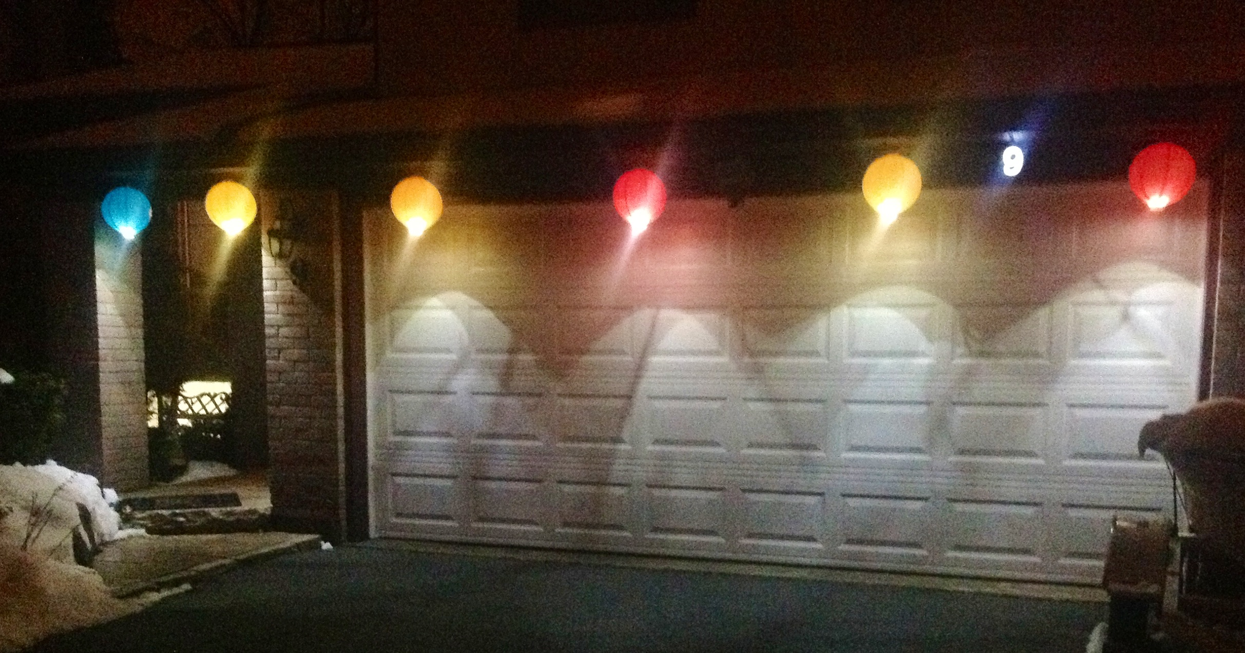

I once had halogen lamps on front wood deck steps with a 200W transformer, so I converted 12Vac to DC inside the unit and replaced a pair with 1x4 LED Alum Clad boards cut down from scrap boards made for Ambulence flashers that were 1x16. Then made a dozen for along the fence line and added to the few in front. There were all running in parallel due to good quality matching in 1W chips fed from 13Vdc using AWG18 wire.
Later in the current residence , ( no pun intended ) I put all these 1x4 same LEDs in a 12.0V regulated wall supply.
Installed into $1 Chinese lanterns sprayed with Urethane and LEDs installed. It's been 3 yrs since they were installed.
and the LEDs were almost free from an Alum. Scrap dealer who got them from Solectron. Note the season is winter, but I use all year round.
According to the 2007 Turuta codebook, the diodes could be any of the following:
BZT52H-C5V1 zener SOD123F
BZX399-C5V1 zener SOD-323
BZX884-C6V2 zener SOD-882
SC016-2 GP, Rectifier, 200V, 1A, Vf<1,1V(2A) DO-214
SD833-04 Schottky Barrier Rectifier, 60V, 3A, Vf<0,58V(2,5A) PowDI123
UDZ5V1B zener SOD-323
ZMS5800 Schottky Rectifier, 50V, 1A, 250mW, Vf<410mV(1mA) SOD-323
Hopefully the package will give away which one.
For the chip I get several possibilities, mostly LDO regulators and various kinds of FET and diodes, but I also found:
BCR420U which is an LED driver, but the package looks wrong.
Is it not possible to make out what the ?? part of the marking is?
