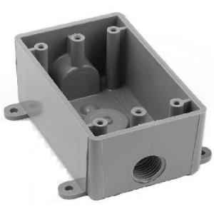

Ok, I guess the stupid Home Depot link only works for me. Here is a pic.

Nice! You think this will fit it just perfect?
I will look into the right parts for you tomorrow. K? I don't much feel like research tonight. It is Friday

Is there a "gang box" that allows you to set up the components like this: designed to allow you to put the 2 plug outlets vertical and 2 dimmer components sideways..
