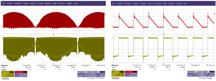

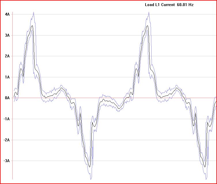

Power factor correction has to do with making a "computer power supply" look like a resistive load. Most things like a TV only take power at the very peak of the sign wave. The current waveform is "pulsed" not sign wave. The current is very high for 20% of the sign wave.
A resistive load has a current waveform that matches the voltage waveform (sign wave). The power company wants a resistive load.
Here's the background draw in my house - lights and electronics. Doesn't seem like much of it is power factor corrected.

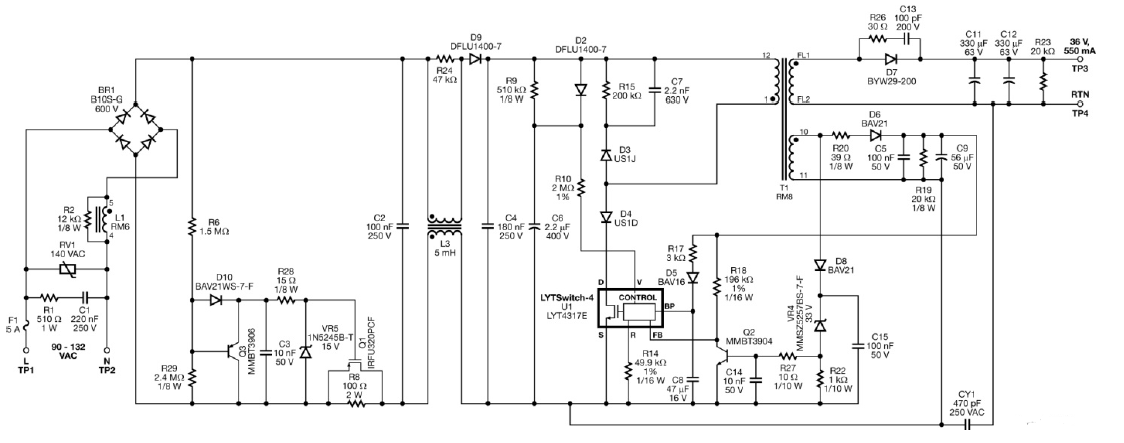

In light bulbs the PFC is very simple. There is not two stage switcher in most I looked at. The design posted above, the IC watches the line voltage. When the voltage is at the peak of the sign wave the PWM runs at full current. When the line voltage is less than peak, then the current in the MOSFET is also less by that amount. They added a multiplier to the output of the error amplifier. error out * line voltage = duty cycle
There is not a second inductor, second (IC + FET + diode). The major change is in silicon.

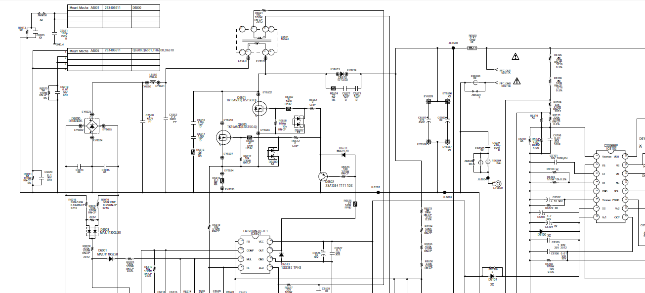

Looking at the schematics of the linked circuit I see how they are doing it and the circuit is considerably different that what I found in my Vizio TV. The power supply it has went directly from the main bridge rectifier right into the main HV DC rail with a several hundred uf 400 VDC electrolytic capacitor.
I don't see how any PFC adjustment could be made in that design given the reasonably low average ripple the large capacitor would provide.
Here's a screen dump (sorry about the lack of detail) of part of a PSU from a2009 Sony KDL32W5800 - this is typical of all European TV's in recent years.

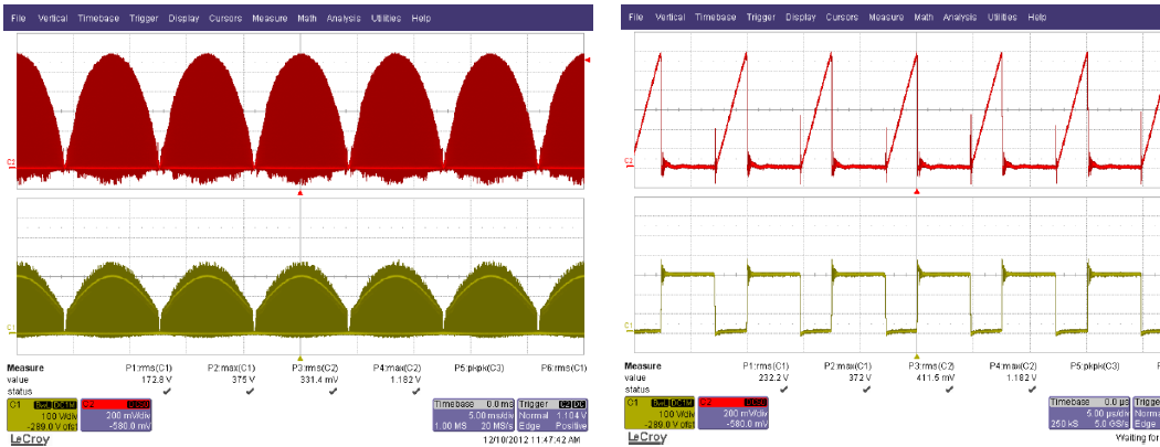

From a 20W bulb with a PF of 0.99.
The input current is close to a sign wave.
They did not have to add many parts to get PFC.
MOSFET current and voltage.
132 VAC, 60 Hz. Power line.
Upper: ID7, 1 A / div. Output diode current.
Lower: VD7, 20 V, 2 ms / div. Output diode voltage.
Picture on right. Expanded waveform
Lower: VD7, 20 V / div., 5 s / div.
