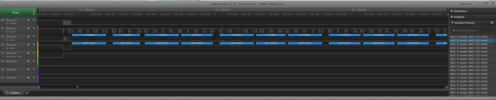

The program link in #1 works, and I've played with it a bit, but so far I've only played with BYTEs which fill the screen or make pattern.
Using a digital analyser on this program,bives unusual results, as the SCK clock doesn't look as I'm used to! See attached.

Wow..... What a piggin struggle... I thought it was the SPI mode at first as it wouldn't work.
The problem ended up in the fonts library... select case will not accept a string object even though only one character is sent...
I have a lil file called ianstest.bas and a new font file... play with it first then you can copy it in as you need.
If you look at my "dospi()" function it has to wait for the SPI to be unbusy... This write the MSG to the screen.
