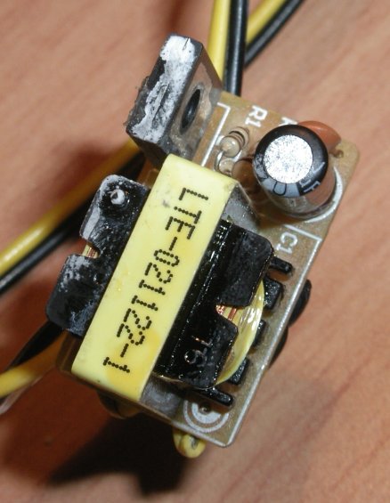

I just picked up a new gadget the other day, and it came with a small power adaptor. When I fired it up, the adaptor makes a terrible high pitch squeeling sound.
I presume this is because its a cheapie. So I proceeded to dismantle the adaptor and see if there was anything I could replace. Inside I found a very small & simple circuit with the following:
1 x NPN Transistor (D882-P)
1 x 50v 4.7uf capacitor
2 x resistor
1 x small orange thing (capaciitor ?)
1 x Transformer
Any idea what might be creating the noise ?
most of the componants are un-labeled, but it takes 12v DC in and by my amature multi-meter skills, it seems to output about 2.3mv
P.S. I've attached a photo for what its worth.

Ah, yes, its an inverter then. It will output around 1200v AC for your cold cathode tubes. 5 pegs is common, it indicates either the primary or secondary has tapped windings. I presuming the primary and this uses the same system as a simple camera flash charger. However, with this prticular problem, its probably cheaper to buy a new unit than replace the transformer as that will be the bulk of the cost of it. If its faulty, the supplier should replace it. You 2n setting on the multimeter is probably for capacitance, 2 nano farads.
The transformer winds and the core have got a vibration, and they make a hearable noise.

Electroluminescent wire actually often makes noise itself when powered. It requires AC in the audio range to function. The surfaces often function as a speaker.

I'm afraid so, it's NOT a standard transformer, but specific to that one application.
try some potting
this will be a fairly permanant solution... find or build a little box or containter that is larger than your gizmo. line the container with wax paper or plastic-wrap. fill it part way with clear or black epoxy glue, fiberglass resin, polyester resin, jb weld, wood filler, whatever... let that layer firm up for 15 min to an hour (check your instructions for "set time") ... then lay in your power circuit, and fill the rest of the way with epoxy... let it sit someplace for a few days, and then pop it out.
the potting should help to absorb any noise from the windings, and it may even have stopped them from oscillating, audibly at least.
Thats a top idea!
The inverter actually came in a small plastic box, so I could just pop it back in and "flood fill" it with resin.
Should I give any consideration to heat ? without any airflow, it might get hot and burn out ? <shrug> .... but thats a very doable solution.
While I agree that potting it would likely help with the noise, 2 problems can arise, both fatal to the device.
Firstly, most epoxies will shrink as they cure. Maybe not much, but enough to be an all-encompassing boa constrictor on the electronics. Think cracked resistors, shattered capacitors, fractured IC's. Not good. There are specific potting compounds designed for doing this, many are urethanes, they remain slightly flexible after cure. Bringing up another point... thermal expansion. When the parts warm up, and can't expand...snap crackle and pop.
The second point, you mentioned also, heat. This device was designed to operate with natural convection to keep itself cool. Not gonna happen very well once it is intombed ( pun intended )
Therefore, if you want to pot this thing, get the proper material ( BTW, JB Weld is likely conductive, being metal filled and all )
One simple fix may be to get some varnish, apply a thin coat to the switching transformer. If nothing else you may change the mechanical resonance enough you don't hear it.

the inverter (thats what you have) shouldn't even get warm, let alone hot, unless you're severely overloading it somehow.
my inverter, which also arrived sealed in a plastic box (no ventilation what so ever) does not feel any warmer than the surroundings, even after running for a few hours. mine is using a TO92 transistor, your transistor looks a bit different, perhaps yours is higher power?
if you want to test things, to see if it will overheat, try potting the unit with paraffin wax ... if there's some sort of problem and the unit heats up, it will free itself of the wax fairly easily ;)
I agree with zevon that shrinkage would be a concern, but I don't think in this particular instance you have to worry much about it, these things are pretty rugged and assembled with all through-hole construction. If it were a bunch of tiny SMD components, it would be a different story.
I suppose if shrinkage is a terrible concern, encapsulate the unit first with silicone caulk, and then pot it using a hard epoxy ... the caulk will act as a stress barrier protecting anything from being crushed by the epoxy.

Ok Folks,
I flood-filled it with Silicone, the silicon has set to a soft rubbery texture. So I plugged the unit into my 12v PC power supply and sure enough, it still makes a racket!
I'm not sure if its any quieter than before, but its still too audible for me to leave it running without getting a headache.
I did email the shop I brought it from who responded with the following:
"Unfortunately all EL inverters will emit an electrical noise (we've tried
several manufacturers). The best recommendation is to wrap a piece of cloth
around the unit to dampen the noise, while still allowing some airflow to
the vent holes."
So it looks like all cheapo asian-made EL gear like this is crap essetially. Which is a real bummer, because simple lights (not going overboard) can look really nice and allmost smooth & classy. I guess with most things, you get what you pay for, and I suppose no-one is prepared to pay for good EL lights in their PC's.
