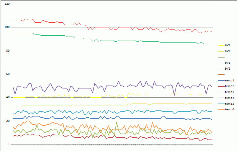

ok, here some readings. Using a 4x1.5battery pack, a 9V battery and copied a bunch of temperature readings in for comparison.
Maybe a 0.5A power supply does not really drive it, need 1A? Or have to twiddle with caps? Has to drive 6, later on 8 LM35s and reads them at the same instance.
Whats interesting, both readings for the Rs should be the same, about 350mV/109 reading, but they differ a fair bit.

Been studying your plots.
For the top two traces, fixed resistors from a battery shows the battery voltage falling about ~10mV, which is OK.
The lower test voltages jump at a point of approx 66% along the X axis.
Most likely a poor connection.?
You do realise the LM35 output is only 10mV/Cdeg change and the accuracy is about +/-0.5C.
I would say the majority of the plot points fall close to the LM35's spec.
Do you have any filtering close to the logger for each LM35 input.

+-1 digits, fair enough, LSB noise. And maybe there is alterations of 1 deg within 1 minute, every now and then. But there are pikes of 5 or more counts.
Maybe I should ramp it up to 6 readings one minute, see what happens.
The 1st picture I posted, 3 graphs are fine, am worried about the others, more than 3 digits noise.
There are filters at the sensor end, as in the LM35 data sheet. 75R and 1µFC to ground from sensor reading. But no, nothing at the ADC input side.

CAT 5 did cut the mustard:
the 2 parallel curves "ins top" and "living floor" is the ones with CAT5 cables. The graph is without the averaging I'd normally use. The 17.5m CAT5 does better than even the "subfloor" which is about 2m normal cable. The lines are parallel because I was testing the sensors first if they would have offset or what not, positioned them next to each other.
I connected 1 pair to voltage supply and ground the other pair to sensor output and same ground (i.e. ground would be 2 strains). The other option may be one pair for the sensor output so in that pair the noise would neutralise. But, seems to work for me the way it is now and the spec says one pair would be signal and its ground, that's how I did it.
