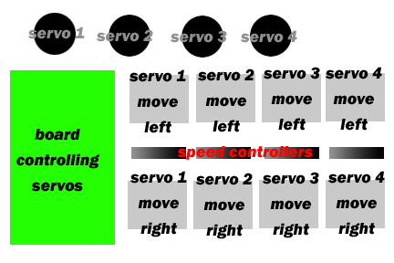

ok. the furthest i have delved into electronics is computer repair and setup. i know a little about audio electonics, but only what i have been told. no "hands on" experience. that being said:
i would like to make a board that controls 4 motors. each motor needs to be able to move left or right and i would like the control of the motors to be dictated by pressing one button for right and one button for left. i would also like a wheel or button that controls the speed of each motor independently. this sounds so basic i feel stupid asking. but i saw some servos that were small enough for my project here:
http://www.junun.org/MarkIII/Info.jsp?item=16
but i dont understand how they are controled. do i need a servo control board? i saw a dc speed regulator here:
and am not sure if this would be a better way of controling the speed outside of voltage regulation. i dont know if this is even necessary. attached is the basic pic of what i want to accomplish. i know this is probably too trivial to be addressed by anyone, but if there are any ideas on which direction i need to go they would be appriciated. thanks!
~robbie
Just so that you are not heading off in entirily the wrong direction, those hobby servos you linked to only have a 180 degree rotation. They won't go round and round...
i want the servos (or other suggested motors) to turn knobs. i want the knob being turned to move from 225 to 135 if zero degrees is on top(see pic below), so i guess the servos i found wont move that far.
i want the servos (or other suggested motors) to attach to the top of a knob(s) and move them to the right when one button is pressed and to the left when another button is pressed (see pic above for vague illustration :wink: ) but at a slow rate. like from 225 -> 135 would take about 3 seconds at maximum speed and about 15 seconds at the slowest speed. but i want the servo (or other motor) to to stop when the button is let go. i.e. it only moves when the button is depressed.

any ideas on where to find servos(other motors) that will move in the manner i want?

Those turning knobs, like on stereo's are usually controlled by stepper motors. Any regular gear motor would have a hard time when you tried moving the knob manually. Do you actually want to be able to read the position of the knob, or do you just want spinny dials?
I'm not certain how easy this would be using passives and standard logic chips. I know it would be fairly easy to do with a microcontroller.

unless you mod them - pretty easy to do.

Yes, that's an option. Good point. As long as you wont be turning the wheels manually, that will work.

lol, that's old now too. You get a PWM chip or a microcontroller and skip the DAC altogether. Just PWM the HBridge.
Or in the case of driving a potentiometer, use a digital pot which, I think, has been mentioned before. totally non-mechanical.

ok. i do live recording and would like access to my input/output knobs without having to dig around in the bag. so all i want is to be able to attach small motors the the existing knobs so that i can operate them while watching the show.
after looking at PWM's and microcontrollers they seem to do more than i want. all i need is to have the motor clipped on the knob and 3 buttons controlling the motor. one that "turns left", one that "turns right" and one that would probably be better as a wheel or knob that controls speed.
i dont want to replace the pots on my preamp due to voiding the warranty.
if using PWM's or microcontrollers will conserve a lot of space as mentioned above, then maybe that is the way to go. but what are my other options? like i said before i have little to no knowledge of this kind of stuff and would like the easiest route possible.
the servos i linked to before are about the perfect size for my project, so if they arent right to use, what is a better solution? how hard is it to mod the ones listed?

RC model Servos are very easy to control with a microcontroller. The driver is actually in the servo so all you need to do is send it pulses. As I recall, its a 20 mS window with a 1-2 mS wide pulse. 1.5mS being "neutral", 2 mS fully one way, 1 fully the other way. You could also use a 555 timer. google has lots of circuits for driving servos. Here's a nice little description (though they say a different pulse width) -
after more research i think ive switched gears(no pun intended). i am now thinking stepper motor (as suggested above) and controlling it with a basic stepper control board. is this the right train of thought?

but, driving steppers is much more complex than driving an RC servo. If i was doing this project, I'd probably choose a servo. since the electronics to drive them is pretty simple.
do your research and come to your own conclusions but i think you might agree with me.
