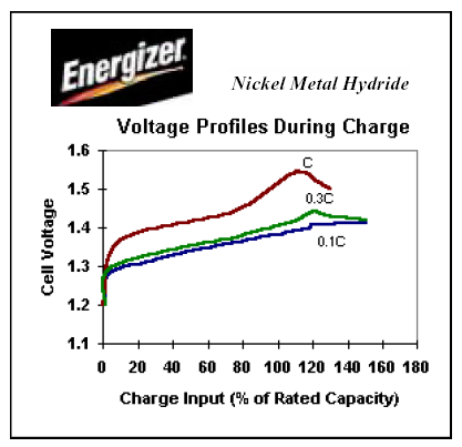

Ok i did some tests i discharged 4 x aaa 1.2v 700mah nimh cells down to 4.06v then i put in the charger for 19hours like it suggested.It charges them at 50-55mA for R03/AAA took them out at 19hours waited an hour then tested with two different multimeters both read around 1.49v is this charger busy overcharging my cells and reducing their lifespan even though ive followed their charging instructions to the letter ?
Why don't you look at the detailed datasheet to see that a Ni-MH cell that is charged at 1/10th its C will be about 1.5V? Energizer recommends a trickle-charge current of only 1/40th C.
Here is a voltage graph from Energizer:

Yes your charger works out of specs, you should get 1.36 or 1.38V the most,
after the 1-2 hours of cool down period.
Even if it has very low charging current, it does overcharge the batteries by topping them that high. (1.49v)
