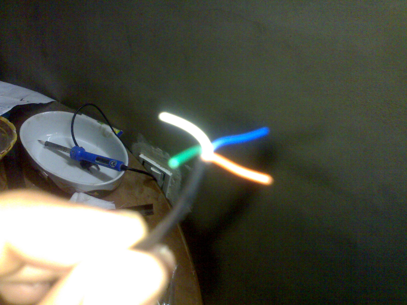

Hi ive got yet another problem! I couldnt find a mount on USB Male port so i cut a USb extension cable and plan to use it in my selfmade Junebug. The problem is that i cant tell which wire is for which signal, the four wire colors are Blue, Green, White and Pink.
