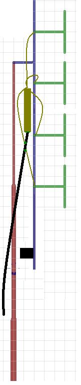

I mounted the antennas the way it was explained, and managed to run the system with only 12 watts of reflected power while the forward power is 1020 watts. I modified ronsimpson drawing a little to gain more height(Will post a photo soon). The telescopic mast is now at 25 meters. I will hopefully take it to its maximum of 34 meters.

This is the diagram:

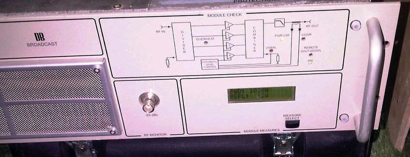

This is a shot from the RF Amplifier I'm using:

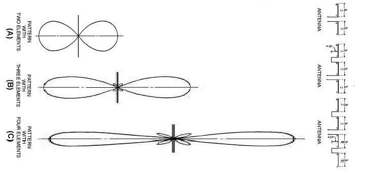

I know that the more the gain the antenna is, the more directional it is. Now, the solution I was given is supposed to radiate power into all directions horizontally. Also stacking antennas vertically like I did is supposed to increase the overall gain, right? So how can these two sentences play out together? Is it reducing power radiated up and down and increasing horizontally in all directions(North, South, East, West) ?
And regarding ERP, is that the number I see in my amplifier? Is that the effective radiated power? In my case is ~1000 watts like you could see in the photo above?
And, the photo above, is it an indication that the overall system is in a healthy state and running optimally since almost no power is being reflected ?

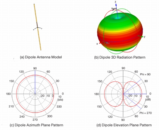

>The first picture is of an antenna with one element. It shows almost the same power N,S,E and W. You antenna is not that good. I think you antenna is -3db on the back side and 0db the other 3 directions.
>Vertically there is 1X power at 0. Up/Down (90) there is 0 power. At 30 there is almost full power. At 60 there is about 1/2 power. No people live at +60. The people at -60 do not want that much power.
>Picture 2 is from a book.

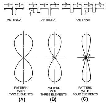

>Picture 3 I changed so it can be understood. You can now see with more elements the power at (0) is greater! The power at 60 and 30 goes down with more elements.

Take it easy on me ron! And you need to define your digits! I know some are angles. Are all of them angles? And the radiation pattern, is it like looking at the antenna from above? or from the side?

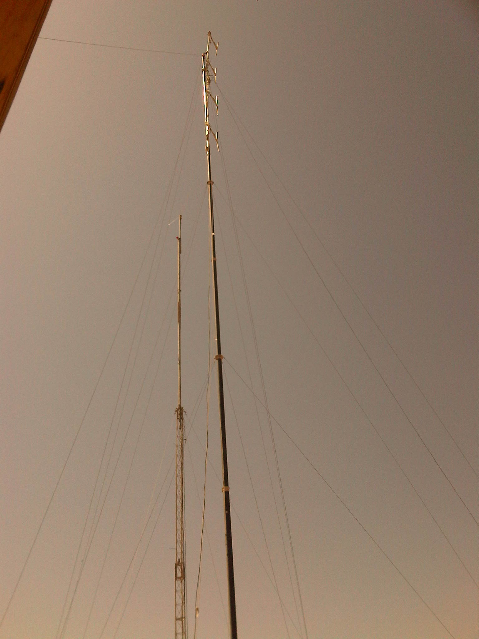

I will come back...need to go now(I'll also post pics of the actual installation so that you can see).

I am using the numbers, angles, from the first picture.
The graph that shows the same power from all angles, 0 through 360 is looking down on the antenna.
The picture that shows power at 0 and 180 and no power at 90 is viewed from the side.
The picture from the book (2) I do not like so I rotated the picture (3) and stretched two of the graphs to make then to scale.

I'm reading about radiation patterns to fully understand your comments. But for the time being, can you answer this for me. If I want to concentrate the signal in the southern west direction, how should my array look like? You can take a look at the photo below.
